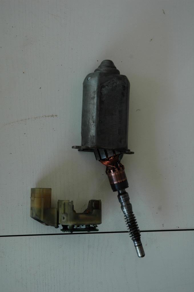

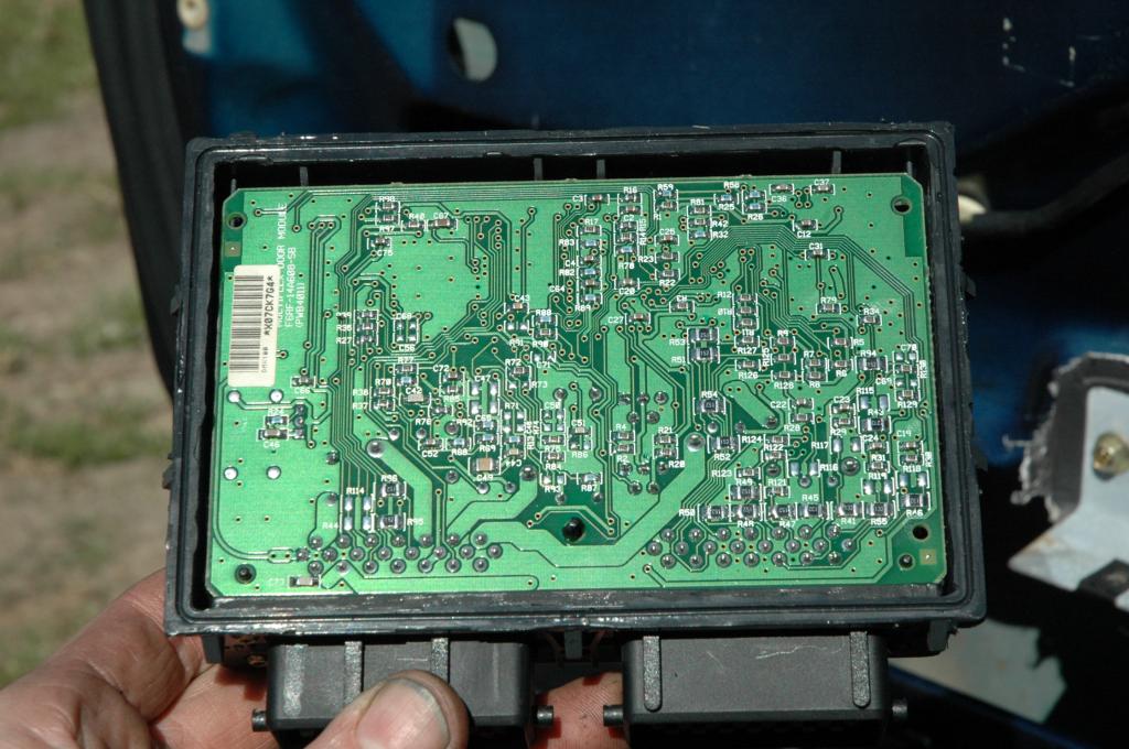

Thanks H2OBOY!! I found out just a few minutes ago that it isn't the motor, but the relay on the door control module... UNFORTUNATELY, all my tools are at work so I can't access the relays for you all to see... I should have gone with my instincts the day I took it apart!! ALWAYS GO WITH YOUR INSTINCTS!!! There is carbon build-up on the contacts of the relay... BUT I was getting a good 12V to the motor... Everywhere I tested, I got 12V... So, the problem has to be in the motor windings, right?! NOOOOO!!!! You need two things to spin a motor; the correct volts and enough amps to spin the darn thing!!! The relay isn't allowing any amps to get to the motor... I ran the motor right from the batt and it spun up quickly...
That is too funny Barry!! Well, I must love her if I am pulling this motor apart without the correct tools... Some allen wrenches will fit in torx screws... UGH!!!

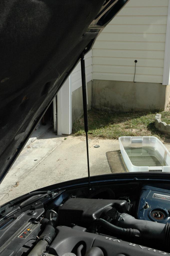

Here is the motor and all it's parts... Oh, and another thing to add to the growing list; Hood strut that finally gave up on me!!! Hmmmmmmmmmmm!!
Good hood strut...
Bad hood strut...

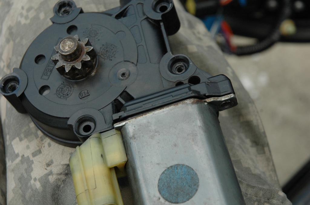

All the internals of the motor... This connects up to the drive gear for the window lifter mechanism...

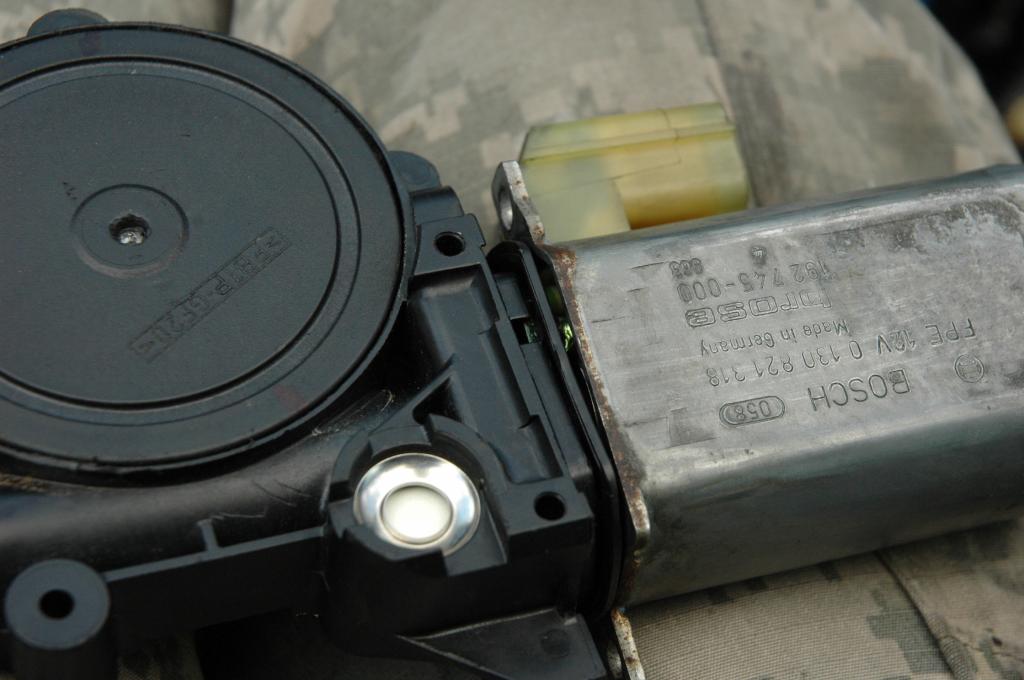

There is a gasket that has a notch it sits in... That is the notch in the center of the picture...
This is the assy together... (OH, for the record; I HATE THE NEW PHOTOBUCKET!!!)

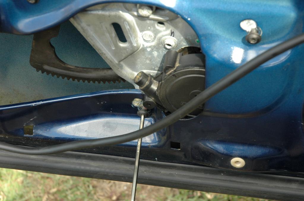

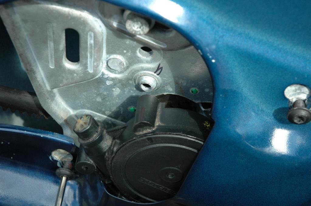

Allen wrench to allow room to get the gear assy out of the door... Loosen these two black screws a good bit... There are two more up higher that you don't need to loosen that much... Just enough to push the lifter away from the door to allow room for the gears to ease out... You'll see if you have to do this...
This is the alignment screw for the motor... There are two more holding this in place... Same allen wrench for these three... If you remove the speaker, you can remove this motor without taking the door completely apart... I wish I had read this before I took the door completely apart the first time I did this... It would've been so helpful... UGH!!

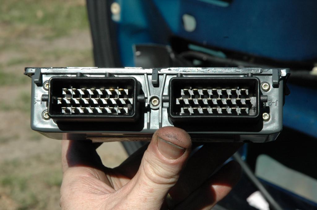

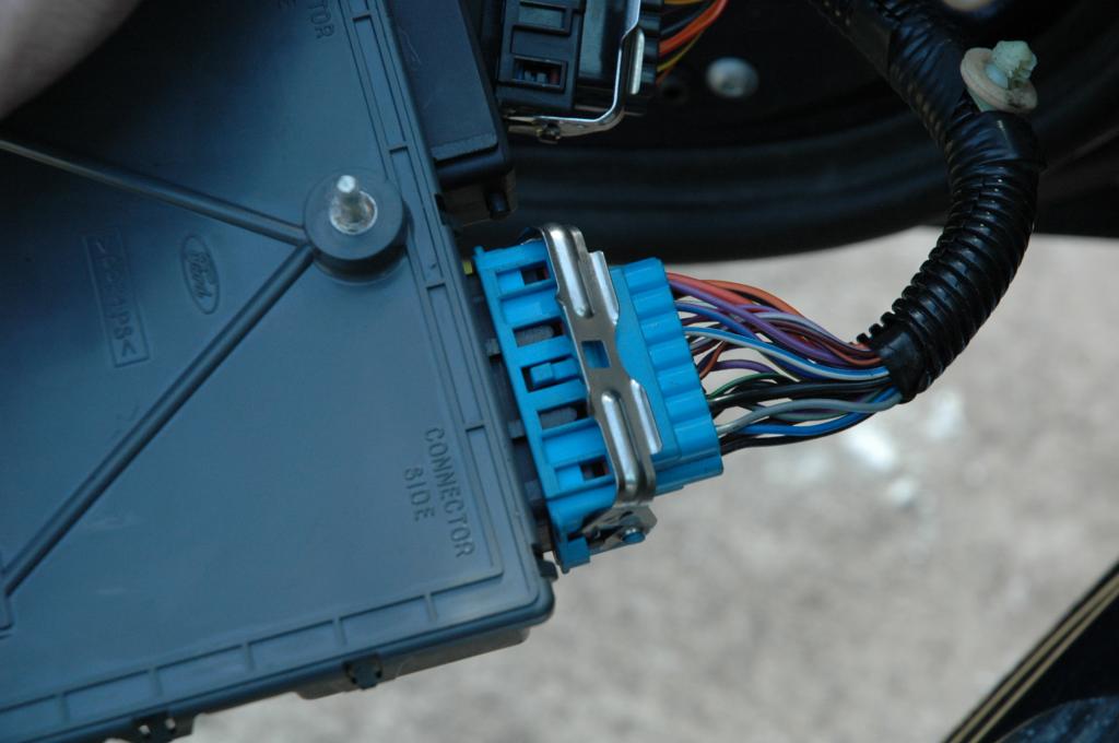

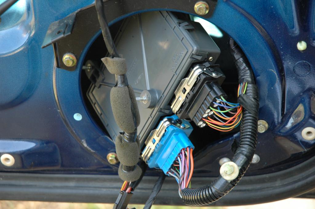

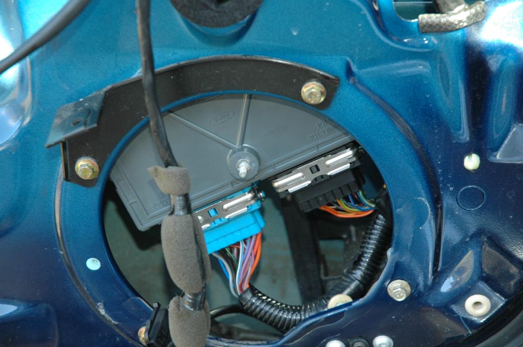

This is the door module... three 8mm nuts hold is in place... There is a wire tree holding the wires to the inside of the door that must be popped thru in order to get this out... the wires are pretty hefty...

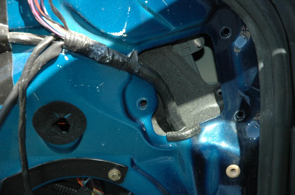

Remove the black felt/foam thing...
Spin everything counter-clock wise down to here (drivers side)...
Then pull the wires out first, then the module...
Okay, the module is protected (sealed) with RTV from the factory... It is a bear to get into without destroying the cover... Take your time and you will be able to get in there... I manage to keep all tabs in place... The cover will state where the connectors go when you put it back together... Or just remember to keep the two mounting screws away from the connectors and you are good...
You have to take these out in order to get the board out and reveal the two relays... I don't have the torx 8 here to get these out... I'm gonna warn you all now that you have to pop the top of the relays (break) in order to see the internals of them... You will see when I get the board out...

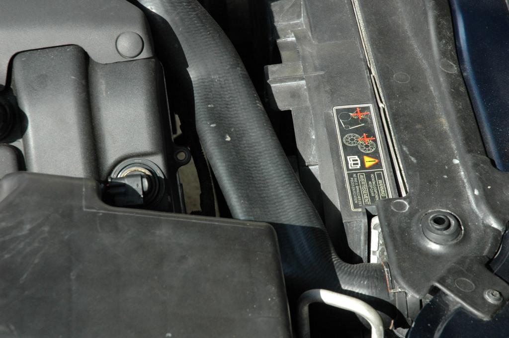

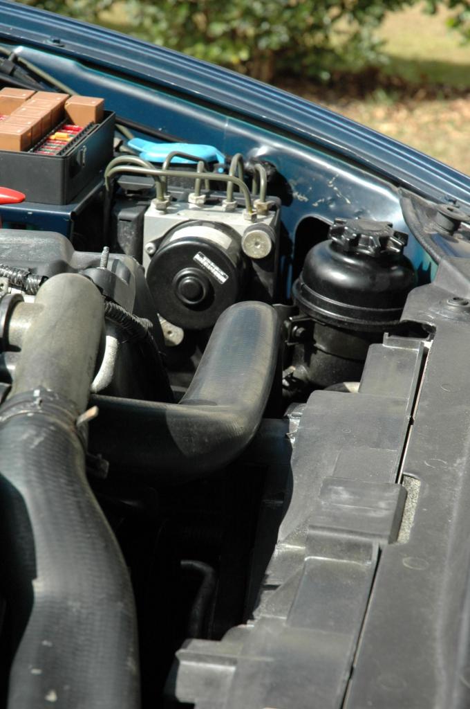

Okay, do your coolant hoses do this when cold?!
I let air in the system and topped it off... We'll see if it happens again...
Ummmmmmm, that is all I have for now... I think I have a high pressure side leak for the power steering... UGH!!!

Your thermostat is stuck shut!

It started doing this right after I did the engine rebuild and put the new thermostat housing in place... It doesn't come close to overheating... I watch the temp needle religiously... I THINK it's doing this because the motor was pretty much at operating temp when I put the cap on and haven't messed with it since... No warning lights; so don't mess with what's not broken... If this isn't normal for Jags, then I must just have negative pressure when cold and nearly neutral pressue when hot...
Thanks!!!

I had the same (collapsed hoses) on my '99, replaced thermostat and flimsy hoses with no change. Replaced cap and all is well.

Blue, don't forget that the temperature gauge is a boldface liar! https://www.jaguarforums.com/forum/x...e-gauge-62813/

Typical of a radiator cap negative pressure vent valve stuck. As coolant heats it expands, pressure builds in the cooling system, and the radiator cap vents excess pressure to maintain its predetermind set pressure.
When the system cools there must be a way to let air back in to replace that vented or a vacuum will occure in the system, hence the negative vent valve. If it sticks closed the result is what you have, a vacuum in the system sucking all your coolant hoses flat.
I'm not too familiar wit the Jag radiator cap, so I don't know where the valve is. Normaly it looks like a little

I was going to say I do not know where that little valve is in the Jag, normally it part of the radiator cap, but as it's a Jag...

If its collapsing with a little vacuum, it'll likely bust under pressure even easier. New hose, sir. it should rebound, and you can squeeze it when engine is cold and push water through the t-stat (cuz its open)
