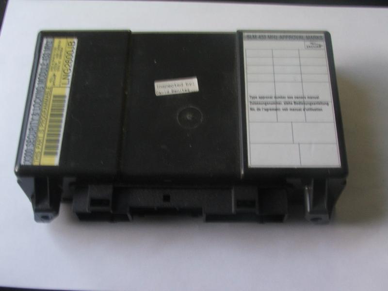

Not sure if this helps, it's an XJ version but might assist.
Thanks!! I found a good number of these on ebay, but I have to run back down stairs to get the number off the module listing in my trunk to see if that is what I need... I actually think my car didn't come with the SLM for some reason... The antenna cable looks tied up as if it wasn't used when the car was built...

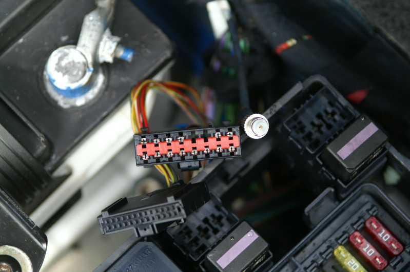

Here is what I found in the trunk... I have the module on the list, but no physical module that I can find... I have two connectors, but I think only one will match up to the modules I found on ebay... The two connectors are tied together so I may just have found the wrong modules... I'm not positive where it goes either, but there is a bolt that doesn't hold anything down right by the rear most battery hold down bolt... It seems logical that would be where it goes as all the wires would be in the correct locations and give some reason to why the bolt is there...

And the mystery connectors... if you look right below the connectors, you will see the (VERY BLUURRY) bolt that isn't doing anything...

Both of the connectors you show plug into the SLM, along with the antenna cable.
The SLM is mounted horizontally directly under the fusebox. It just snaps into the bottom of the fusebox, there are no bolts.
You will need to match the part number and VCATs (program) code, which is 015 from your label photo. If the VCATS is unknown, try to make sure at least the module you buy is from the same model year and body style.
I see you are also missing two relays (black with purple stripe) which are needed to raise the rear windows.

This the SLM as mounted below the Fusebox on my Car:
