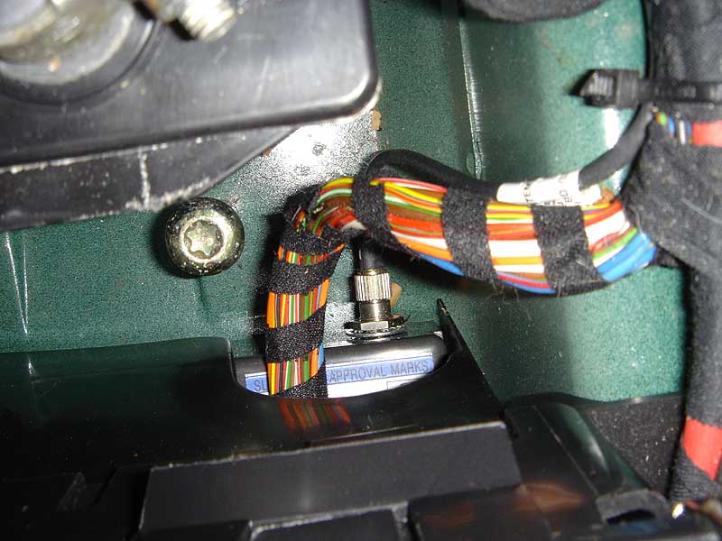

This the SLM as mounted below the Fusebox on my Car:
Thanks Paul!!! Well, it is official, I don't have one... And the search is on!!

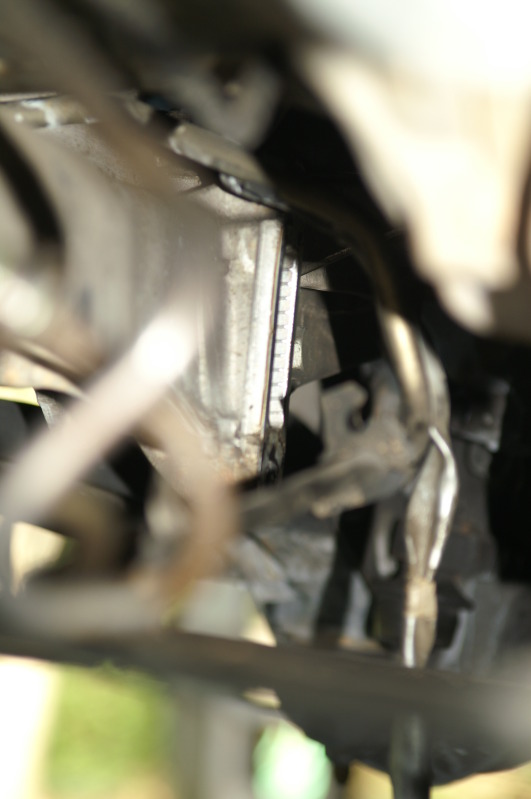

Good day everyone!!
It has been a while... I've been busy working on cars... Other people's cars...
So, I got tired of seeing the cat just sitting there... I had today off and decided it was a good time to dig into the steering rack... This is what I found...
It was pretty easy to get the darn thing out... All things considered compared to other cars... Four bolts that hold it in place here...

One bolt that holds both of these in place... Small 10mm...
Pull both of the rear X-brace bolts... This does two things... Supports the rack until it is ready to pull out and controls the weight when you are ready to remove it from the car...
Don't forget about the connector and the steering shaft bolt...

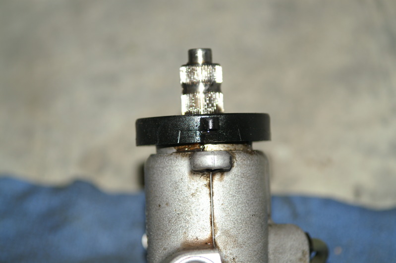

Up in the air, both sides turned outward... Okay, the heart of the issue... Here is the part number tag and casting... I wonder if the casting is for the tube and the plate is the whole assy?! Or this was rebuilt by the dealer and the tag indicates the rebuild...

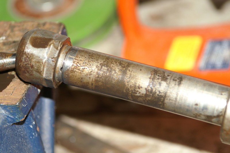

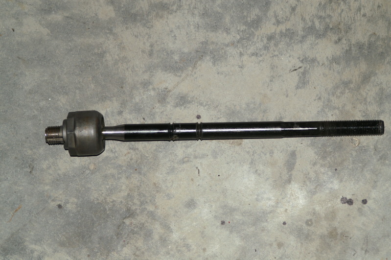

This is NOT the issue with this unit!! I found out when I pulled this apart that this bent inner tie rod (did I mention you can't get this?!?!!? UGH!!!) was just a result of an "I don't care about your beautiful car" towing company... There are marks where it looks like it was pulled from somewhere by this tie rod... I could not get this one off until I had totally torn the unit apart... It may have been easier to remove with the unit in the car...

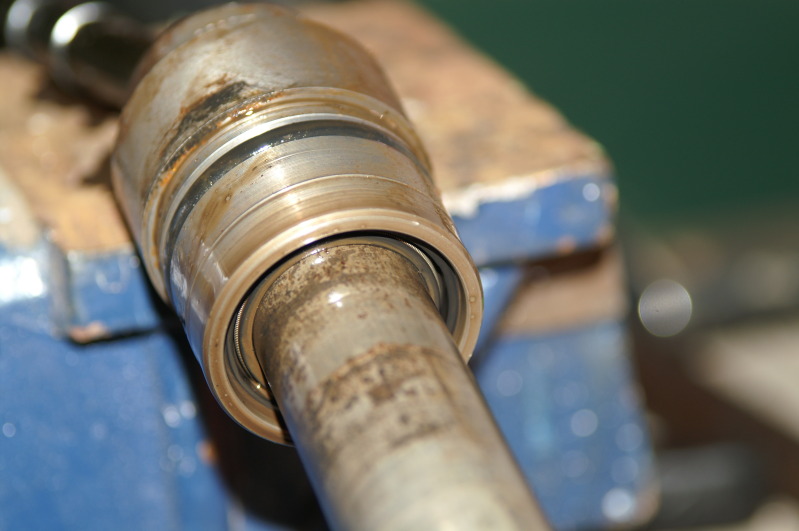

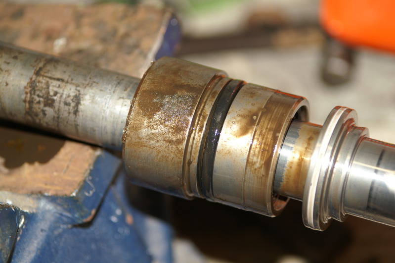

And the NOT so clean side... The reason for this failure...

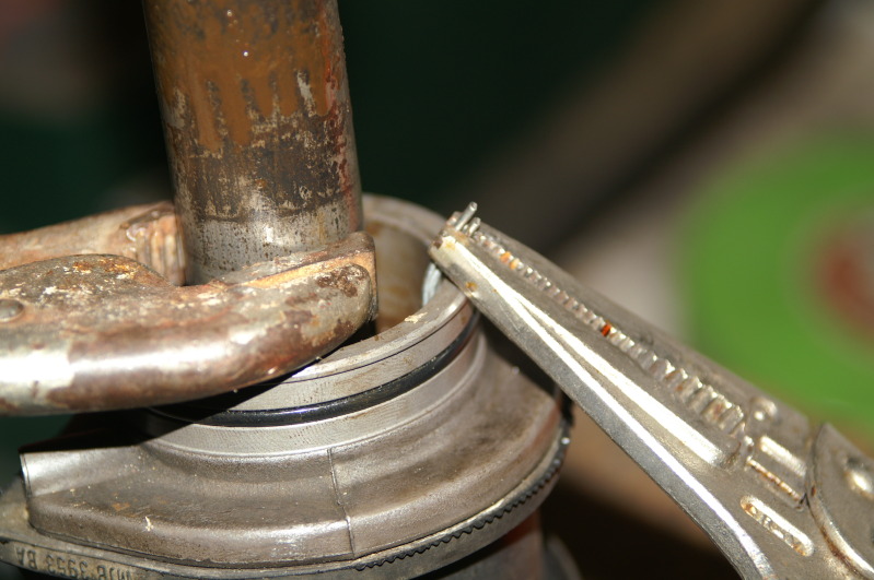

This was the hardest part of the process!!! It took me about an hour to get this stupid ring to come out of it's home... Oh, this unit looks like it was rebuilt... Water must have gotten into the right boot and rusted the main shaft that ruined the seals...
Once I got it most of the way out, the ring made it to the top of the opening and it pretty much popped out... After that, this part below popped out of the main tube...

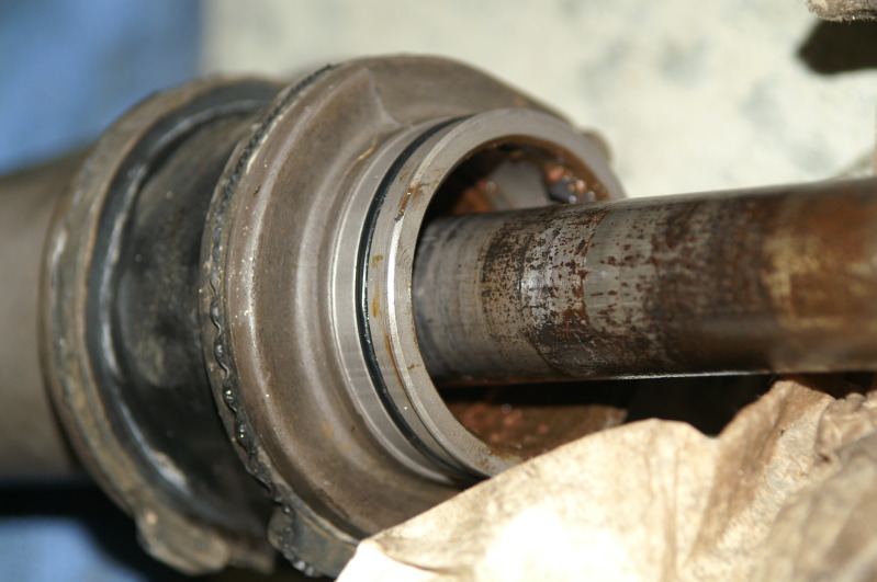

And the seals that are leaking...
and the reason why... Rust!! I hate rust!!

by the way, my indy shop slightly modified an s-type inner tie rod to work on my rack...they found out by trial and error when they needed one, and an s-type was on the lift at the same time...its been working for a couple years now just fine.
Just FYI, in case you feel like doing the rebuild yourself.
