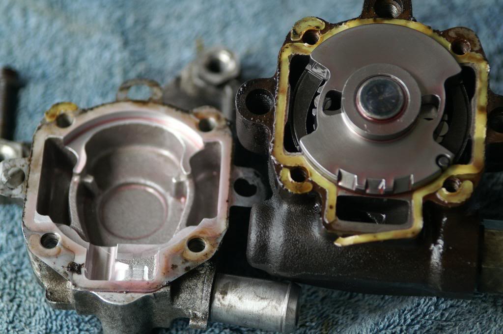

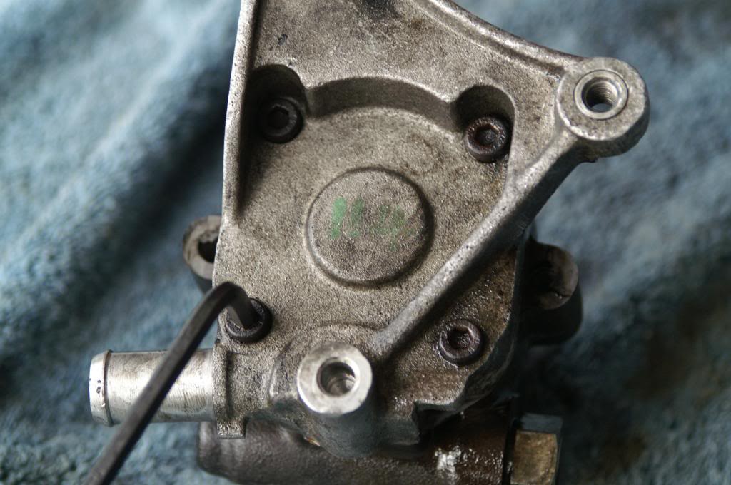

So, I think I had a leak at the power steering pump... I took it out and tore it down... Here you go:
It is held together by four 5mm hex bolts... These weren't too bad to get loose...
And this is where I think the leak was...
Too easy...
(HAVE I MENTIONED THAT I DESPISE PHOTOBUCKETS NEW UPDATE!?!?!?!?! Don't fix what isn't broken, cause now it is!!!!!)
Here is the break (yellow stuff) and the clearish white gasket (on the left)... I used the solid gasket to trace a replacement using the cardboard from the back of a thing of paper... I use the single sheet cardboard, not the box cardboard... (finally got the pic to copy from photobucket...)
Note the pin and spot for it on the top part... This is stationary in the pump... Also note the bronze bushing in the center...

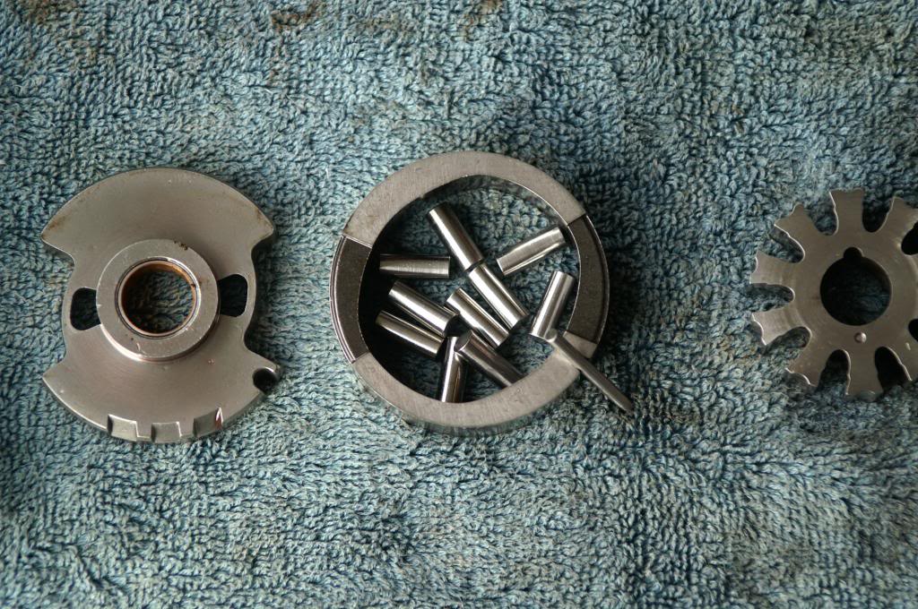

These came out next... The pin just sits in there... there are ten of these bearings...
The drive gear for the bearings... The "keyway" at the top of the center is where the little pin (in the center of the next picture) goes... It locks the center shaft to the drive gear... What I didn't get a shot of is the cutout for the pin that is in the center shaft...

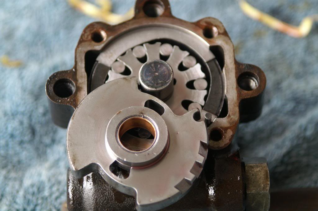

This plate is actually two plates... the other side has a rubber gasket (next pic) that mates up to the steel pump body... Note the pin...
And where it goes... Also lines up with the long locating pin...

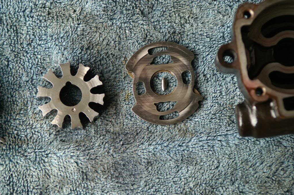

And the interesting part... The bearing for this is pressed on to the shaft, but doesn't see any fluid... The seal is on the opposite side of the bearing... This came out pretty easily...
And finally, this is what is on the other side of the high pressure hose... In this order as it came out of the pump...
Too easy...

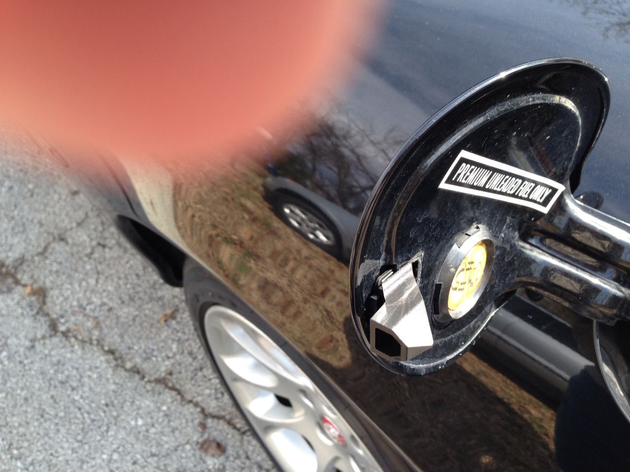

Well, the good news is that I fixed my fuel door issue... I've not had a good plastic part that attatches to the door since I got the car... So, it has been flapping while driving... I just recently had my electric wiring installed in my shop and I have lots of wire left over... I took a good length of wire and made a loop to catch the factory plunger and it looks perfect... Operates the normal way and you can't even tell it only cost me about 0.0000823 cents... I'll try to get pictures tomorrow...

In case you're curious on how much $$$ your DIY fix saved you. The piece that you made from wire for 0.0000823 cents to replace the plastic catch on the fuel door flap, cost me $18 plus $10 shipping from the Jaguar dealership! For crying out loud, it's a chunk of stinkin' plastic...not gold!!!

That is exactly what I thought too!! I looked on the website and didn't find just the plastic part... So, I called them thinking I would have better luck talking to a human... Well, Hampton Jaguar here in Lexington did not OR would not sell me just the catch, but insisted I buy the whole door with catch for $81 plus tax...

I got the part from Tulsa Jaguar in Oklahoma. The parts and service managers both dug into finding me just the Fuel Door Striker Latch without having to purchase the complete fuel door. They came up with part number HJA3097AD. They said it was kind of an obscure listing for just that part. They ordered it and shipped it to me. Their web address is www.tulsajaguar.com. They're good folks!
