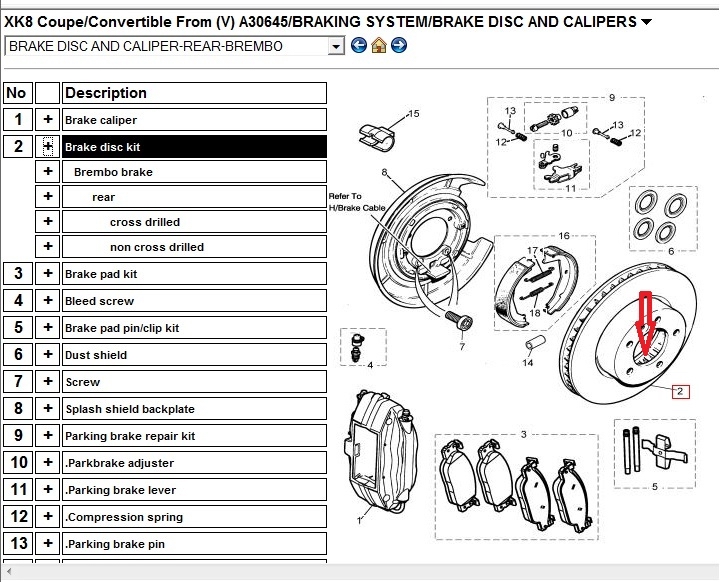

I may not have described the action of the Parking Brake shoes clearly.
The shoes (item 16) expand against the inside (arrowed in red) of the Brake Disc (item 2) to prevent rotation:
This is the Brembo rear brake but the standard rear brake has the same Parking Brake setup.
