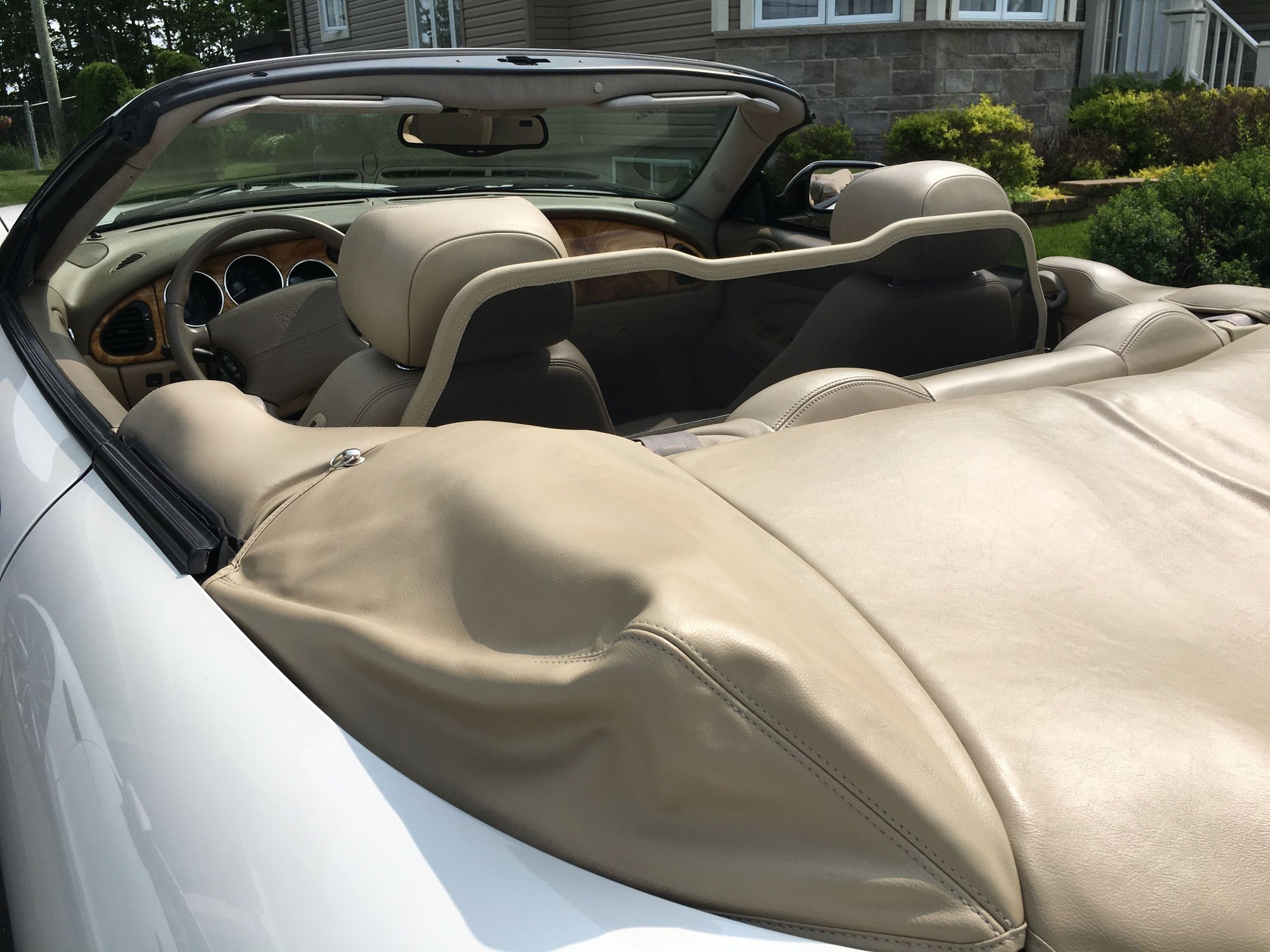

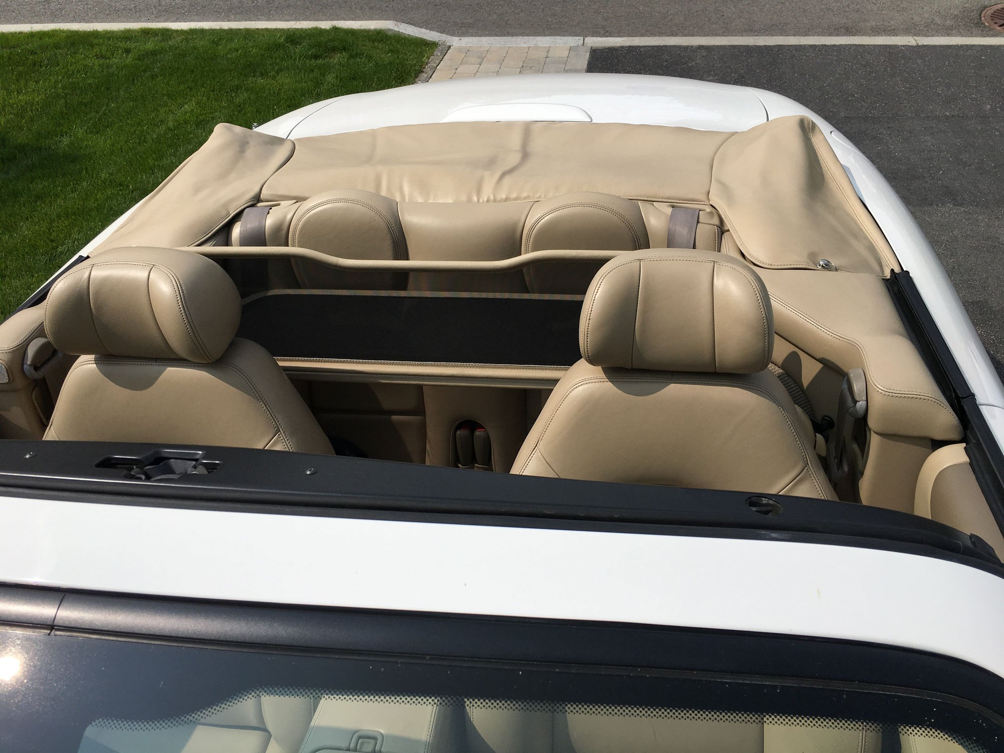

PS: i am from Québec, Canada, just bought a Wind Deflector from DCR auto parts in England. Amazing product and even with the shipping, custom, it is cheaper then EBay. And much better look on my Victory Édition.

Love the windbreak. DCR always has good stuff.

Your car is an identical twin to my wife's 2006 Victory Edition. First one I have ever seen that looks exactly like hers....
