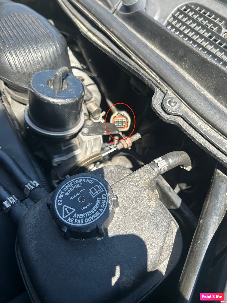

I found this connector covered with elecrical tape. It's on the same harness as the throttle body. Anyone know what this is for?
What is this connector's function?

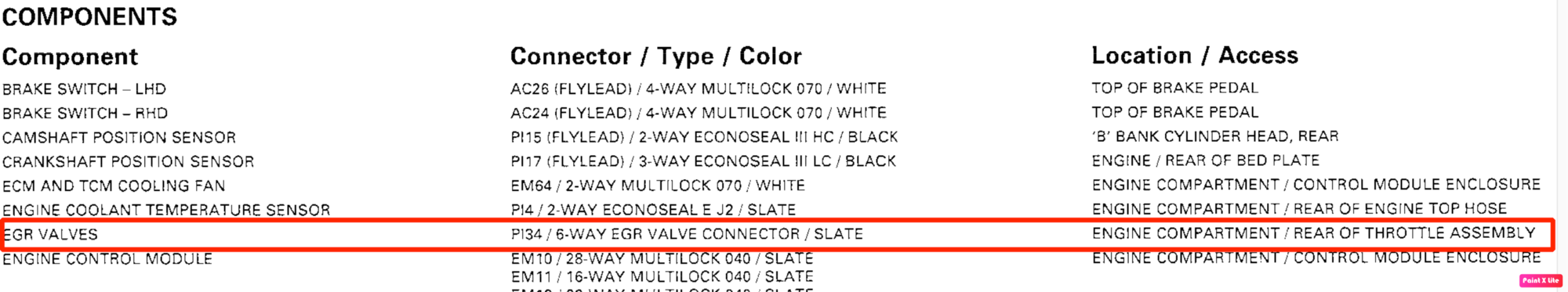

You have AJ26 engine management but a MAKE MODEL YEAR would be better to get the correct info. (VIN ranges?)
Maybe the plug from the DELETED EGR?
File Type: pdf

It's a 1997 XK8 convertible.

From your info I believe it is an EGR connector.
