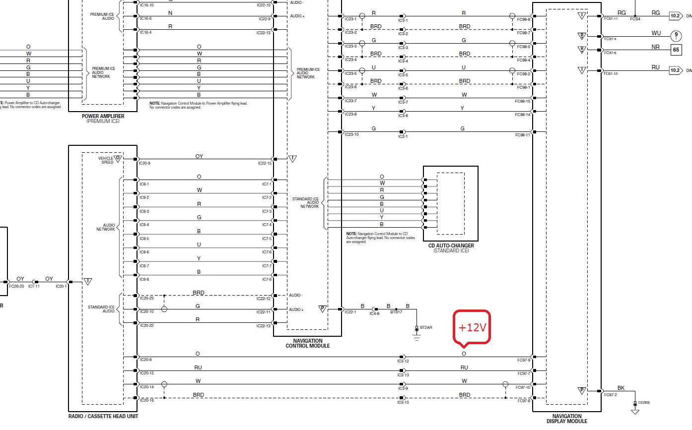

The screen should work without HU, but I haven't tried so far. At least, you have to feed the 'screen enable'-signal to the screen. This means: provide +12V(positive battery) to contact FC97-9 ( orange wire) of the display-connector. Without this, the screen remains black. Maybe you can take positive battery voltage from FC97-4?
Greetings Wolf!
Attached Thumbnails NAV Clock with no head unit?-electrical_scheme_navigation_edit.jpg
