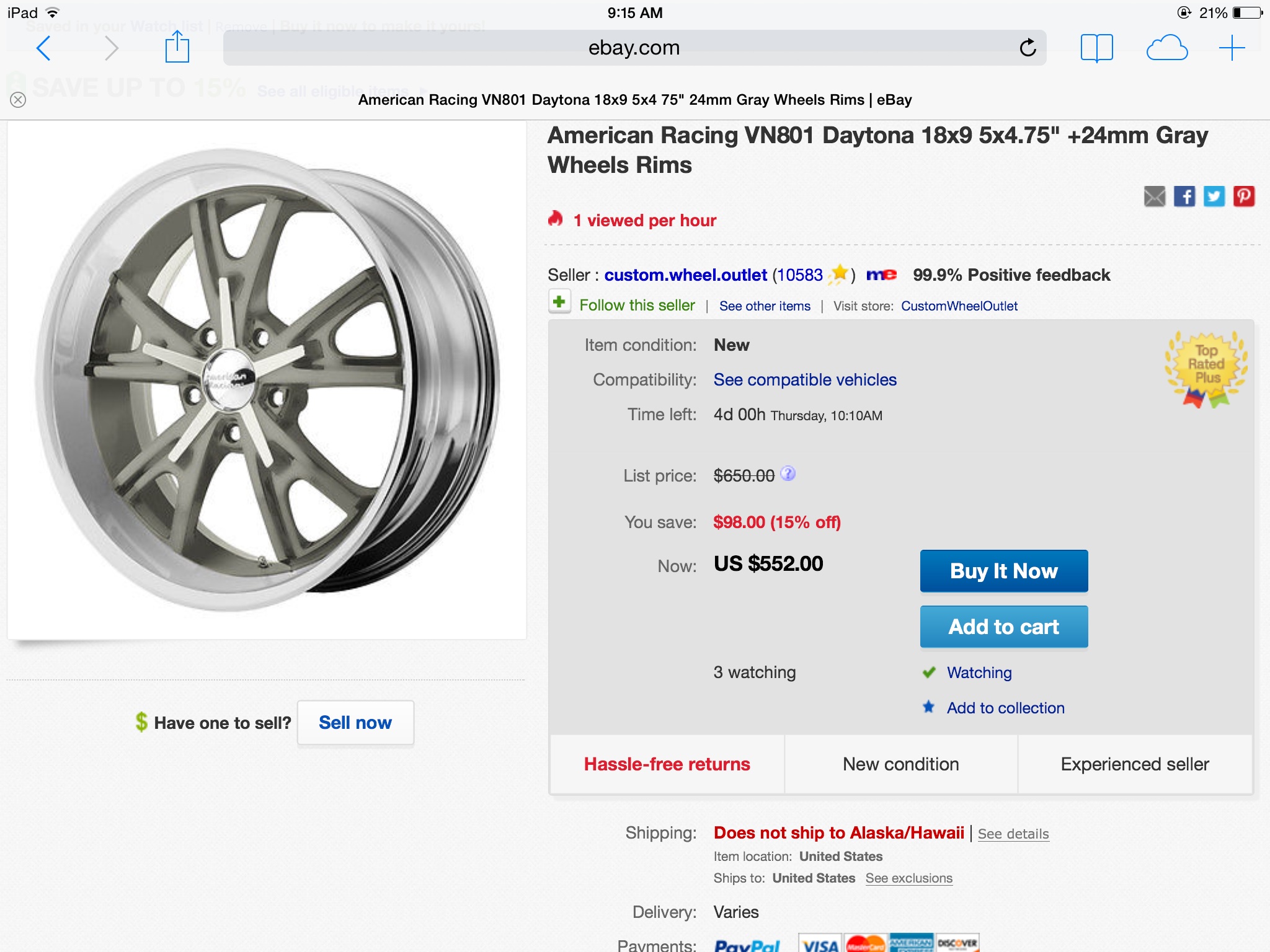

Been thinking about going to wires which I love the look of but they are expensive. Came across these and I really like the look but not sure they will fit.
These are 24 offset and I know I need 33 for 8" rims and 35 for 9" rims for non- staggered so would a wheel spacer take care of the offset issue as well as the bolt pattern and concentric hug matching?

Plan to call American Racing on Monday to get some details. I'm thinking of just going with 9" on both front and rear so I can rotate them. My concern is the bolt pattern and the hub, well need a spacer for the offset differance but only around 10mm

That ad reads like the price shown is for 1 wheel, not 4. Better to ask than assume.
And the ad states they do not ship to Hawaii.

If you look at the add on ebay it's for 4, also free shipping to lower 48 so I would ship to a friend in CA and have them sent on to Hawaii.
Minimal safe adaptor/spacer thickness it 20-22mm.

Anyone have comments on the offset issue. Using a 9" wheel on all 4 with a 24 offset, what size spacer would be best to use?

Less than 20, what thickness exactly? Mounting such spacers in 300+ bhp heavy car is IMHO asking for trouble.
In front you can not use spacers together with 9" rims with 24 offset.

On the rear a stock 9" rim has 35 offset , I think, so a wheel with 24 offset would need a spacer around 10. Would this be correct?
On the front stock is 8", so are you saying the 9" rim would make up the differance between the stock 33 offset and the new 24 offset rim?
No. The 24 offset rim will be extruded 11 mm comparing to 35 rim.

I actually like those wheels. I don't know what to do about hub bore as its smaller although a spacer may be able to take care of that if it has a built in eccentric of the correct size.

I sent an email to American Racing to get some more details on the rim but no reply yet. I'll give them another day or so then I'll call.
The rim is in their American Muscle Collection, I like it a lot.
