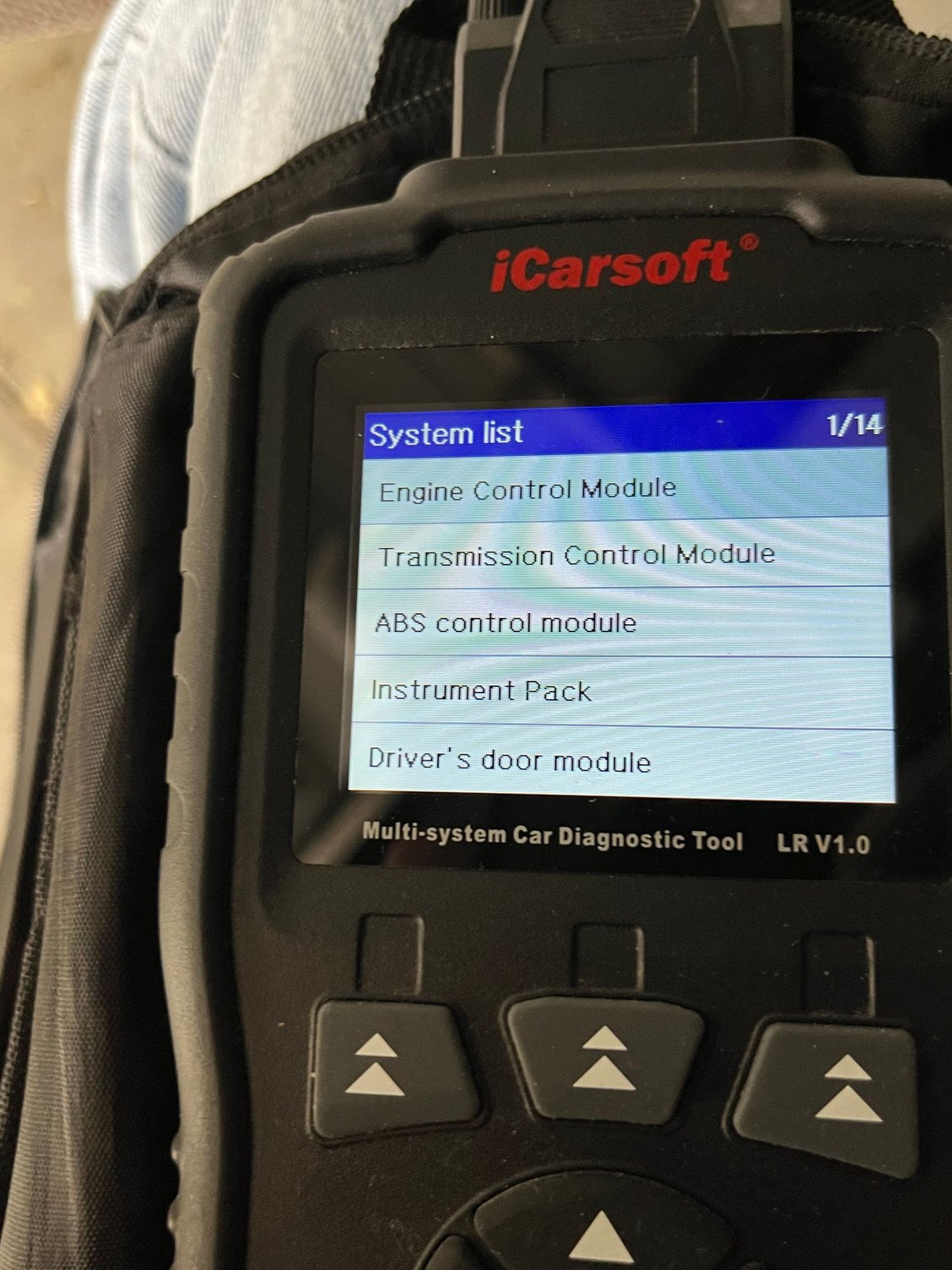

just run the engine module test and you are there with all the data

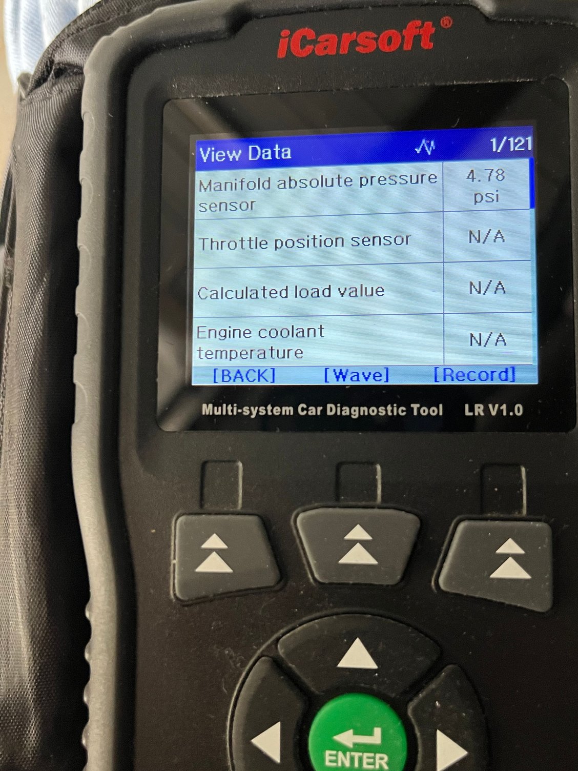

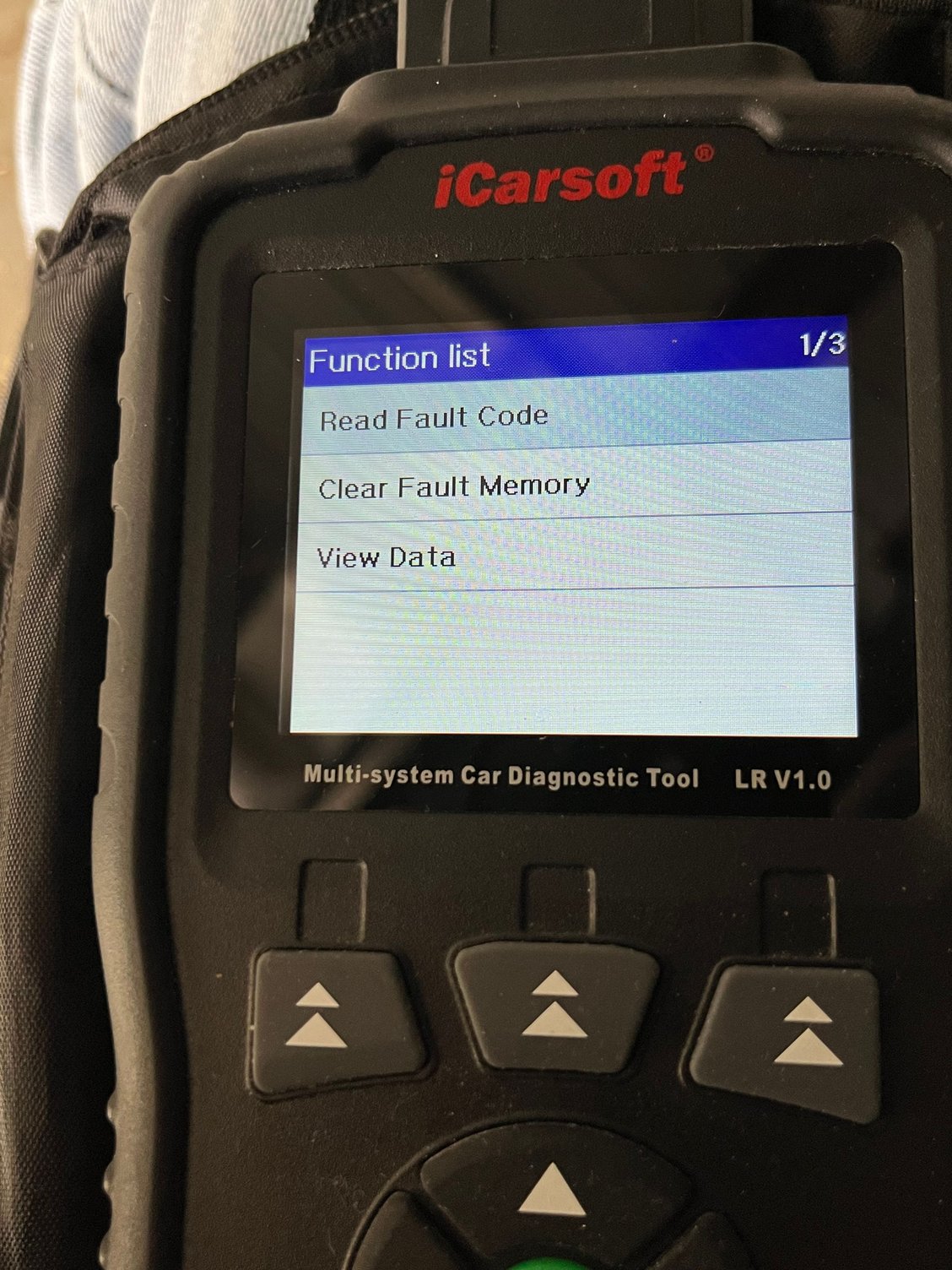

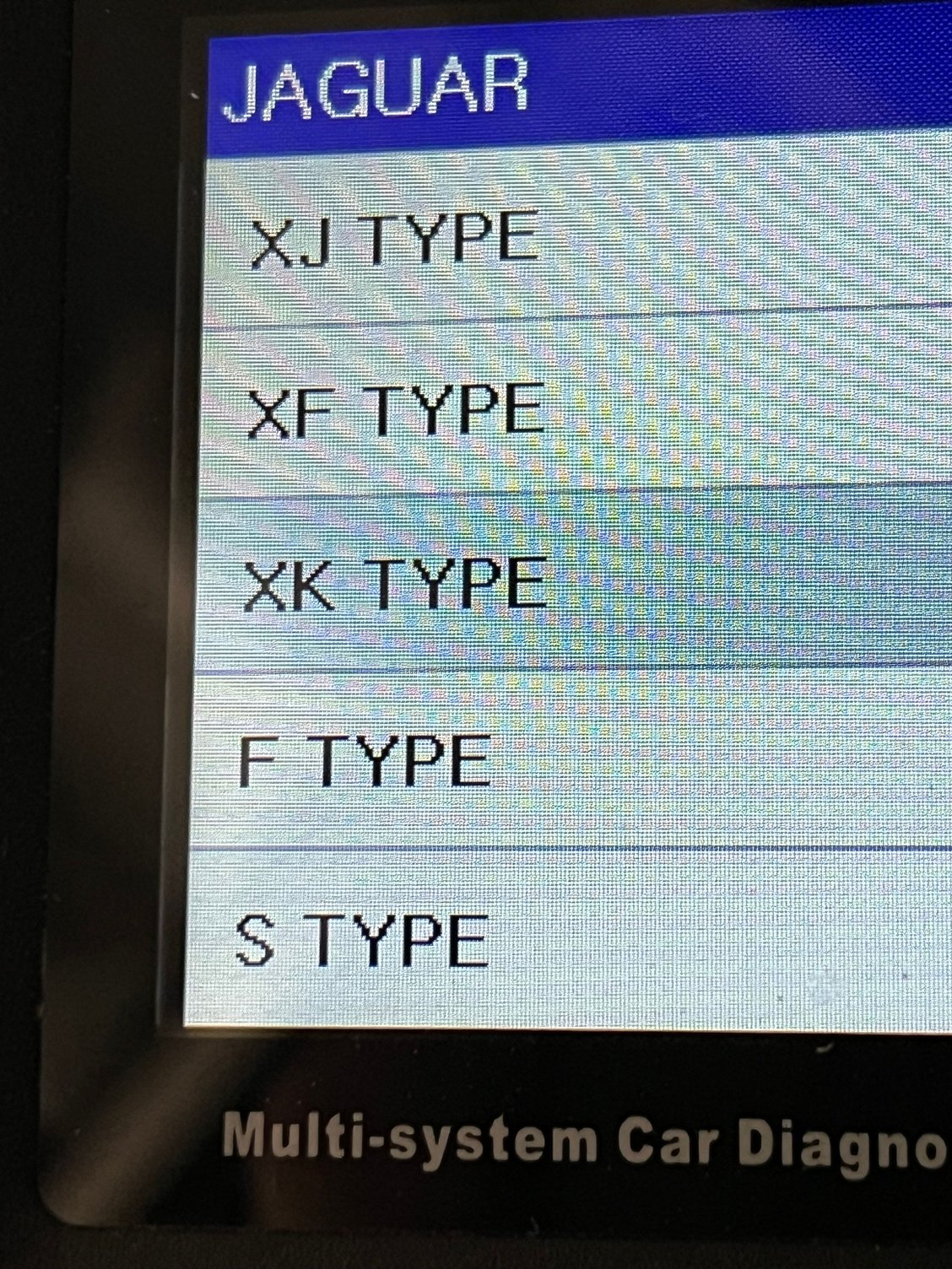

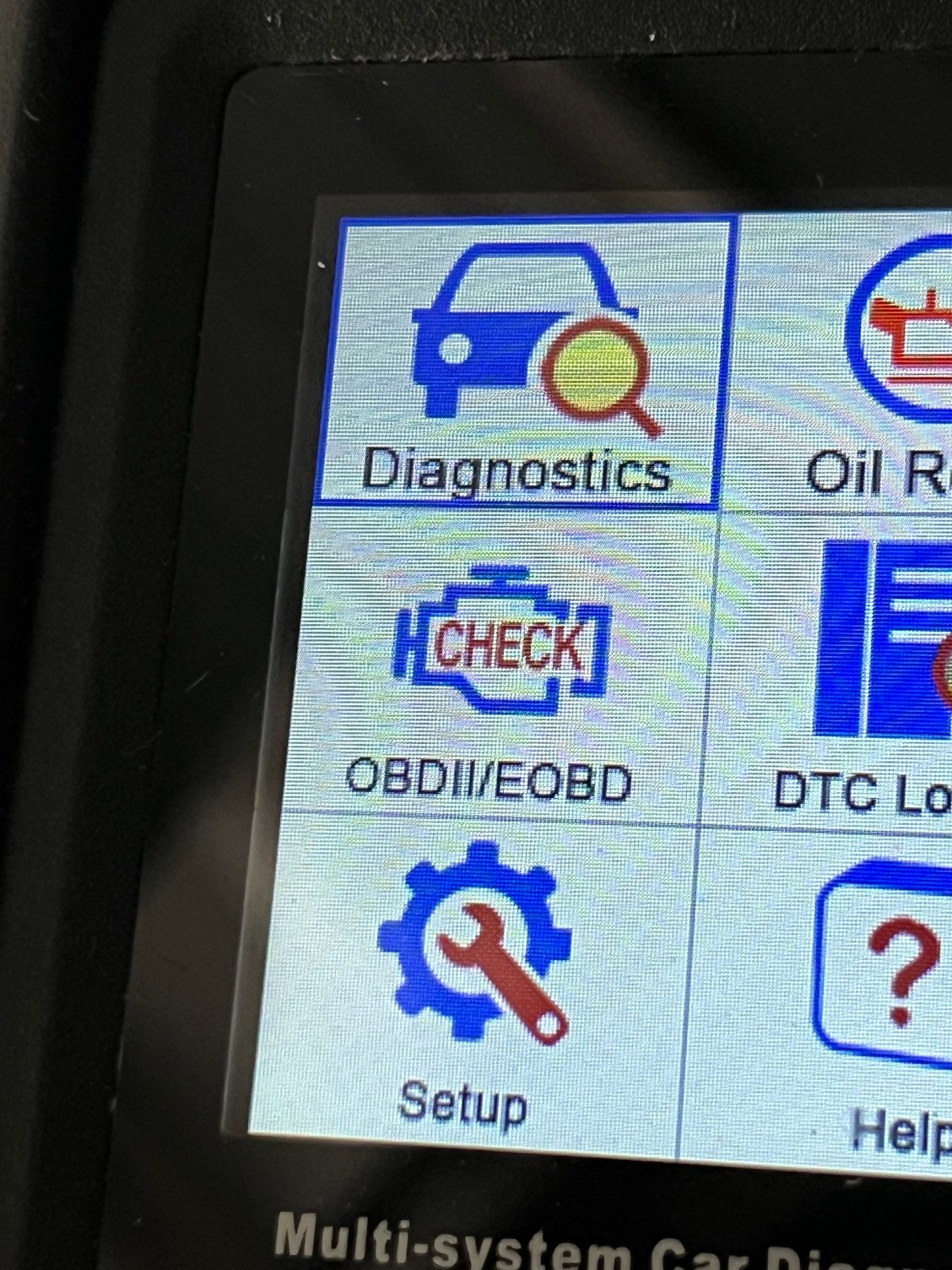

Originally Posted by zray
here are some photos showing the sequence that I use for my icarsoft LR v 1.0 :
I always use the Diagnostic selection . Using the OBD-II gets me nowhere
Choose view data unless you are looking for particular fault code
Many times you can scroll thru the info and find info that is displayed fully that was shown as N/A previously.

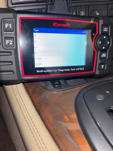

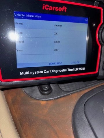

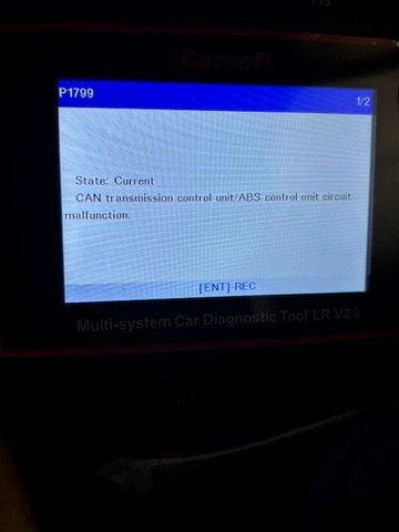

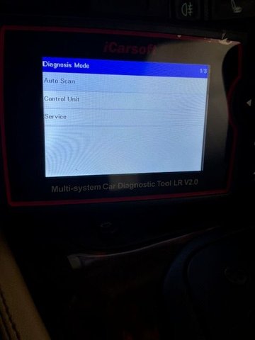

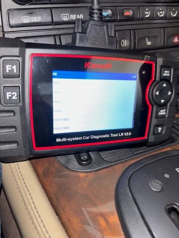

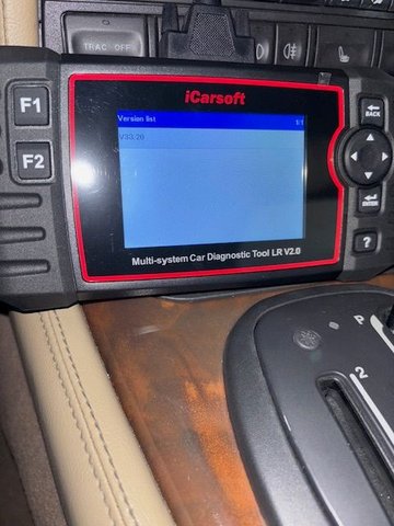

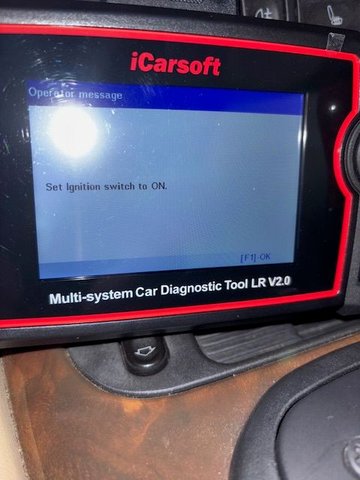

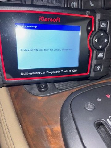

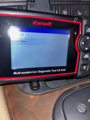

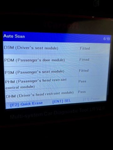

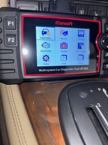

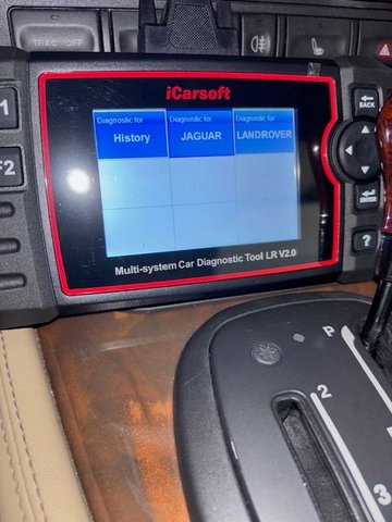

OK this is what I get when my LR V2.0 is plugged in: (sorry about the size of the photos)
There is no system list screen that brings up a function list to select the engine control module. it just allows me to run the auto scan. And now I got the fault codes that you see. I guess I'm driving a stolen car!! Better watch out for "50"

This is why, if I can ever get this car registered it's going to be sold and I'm buying a car with no computer in it. At my age I'm too damn old for a car to have more than an engine, gas tank, gas pedal, and a key. All I want is to get in, turn the key, put it in gear, step on the gas and go. I don't need the government telling me if my computer monitors have reset to the point where they can tell my car to run. Should have never sold the '62 Healey!! :-)

Looks like the LR v2 got improved over the v1 to the point of uselessness.
Glad I was too cheap to get the v2
is your engine running during this diagnostic routine ? Or just the key turned to “ON” ?
if my engine isn’t running I have no results from the LR v1
Z

The instructions say to just turn the ignition "on" so no, the engine is not running. I can go turn the engine on and see what happens.

PS: keep scrolling down and you will find the fuel trim numbers . If they say N/A just keep scrolling down and the next set of them might be active. At least that’s the MO on my icarsoft LR-v1

PS: one can not rely on just the instructions. They will always be incomplete.
you have to experiment. Try the “Diagnostic” selection instead of the “OBD-II” selection and see where that leads, etc.
