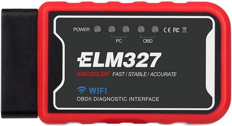

I don't know if this thread is still open but I've also been searching through threads to find a recommendation for either an OBD2 reader or an ELM327 / iPhone app combination that will work with my newly acquired 2001 XK8. My understanding is if I go with the ELM327 I'll need one that is wifi compatible for the iPhone. I found this on Amazon:
Amazon Amazon
I've also found an iPhone app called Car Scanner ELM OBD2 with 23K ratings putting it at 4.8 start.
The ELM unit is supposed to be here tomorrow so I'll fire it up and see what I get. The problem, which I posted in another thread, is that I keep getting a check engine light along with dashboard messages saying "ASC NOT AVAILABLE"," TRAC NOT AVAILABLE" and "FAILSAFE ENGINE MODE" when I start the car. I've tightened up the battery cable and sometimes I don't get the messages and other times I do. It seems that after several starts the messages go away but the check engine light stays on. Then after driving, stopping and starting it up again the check engine light goes away. When I took it to get smogged the guy at the station put his reader on he got a "Air Mix Solenoid Circuit Malfunction". I checked with my reader when I got home and got nothing. We'll see what happens when the new unit comes.
I'm seriously thinking about going back to pre 1965 cars again. No computers, no smog, just crank up the power and go!! LOL.
Joe

Well the one I ordered above does not work with my car. Back to the drawing board. After reading the above posts I looked for the iCarsoft's i930, however, iCarsoft does not make it anymore. I found an iCarsoft on Amazon identified as LR V2.0 (Enhanced Version) which claims to be specifically for the LandRover/Jaguar. I suppose I'll find out when it gets here tomorrow. It's a corded reader rather than one of those bluetooth/wifi units so it's all self contained.
Anyone know the difference between the LR V2.0 and the LR600 V2.0?
The saga continues,
Joe
