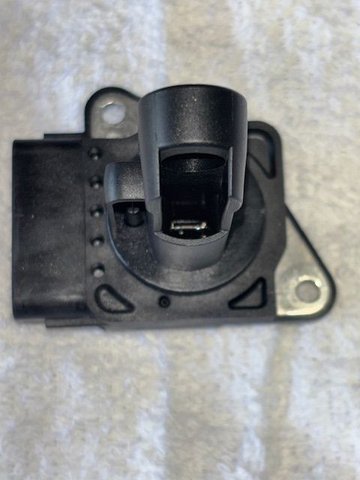

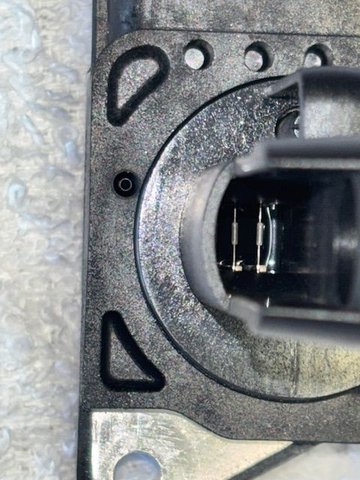

Just for jollies I cleaned the MAF sensor and it did not help clearing the CAT monitor.
