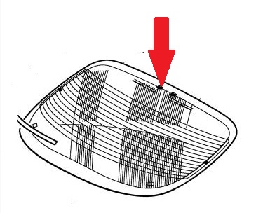

Have you cleaned the inside of your rear window recently?
The symptoms you describe CAN result from dislodging the press-on security system aerial connector at the top of the heated rear window on the coupe.
