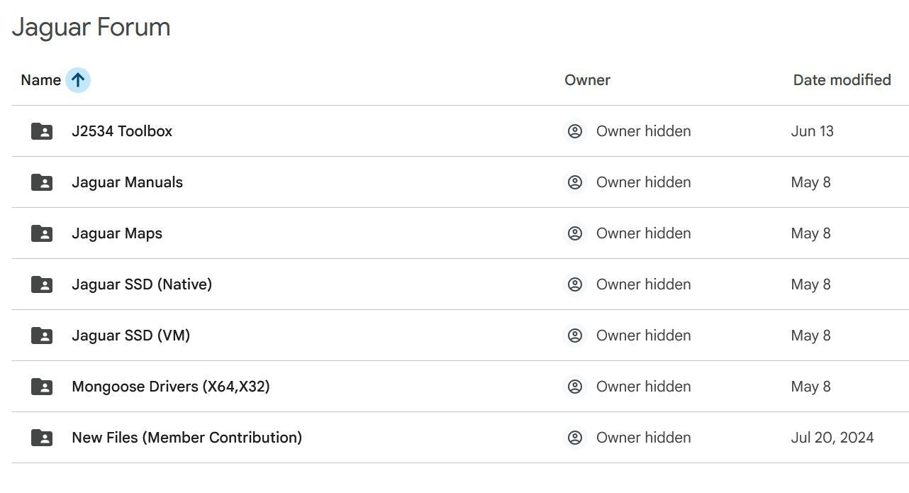

Sanchez I don't understand?
Here is the link in that thread;
I circled the link in red above.
There is a link in that thread that goes directly to here?
SDD Images
I can't see why you could not download this??
I just checked and it's all live and ready to go.

That caught me out at first. You have to click 'see more' in the post to expand it to show the text containing the real link to the google drive.
