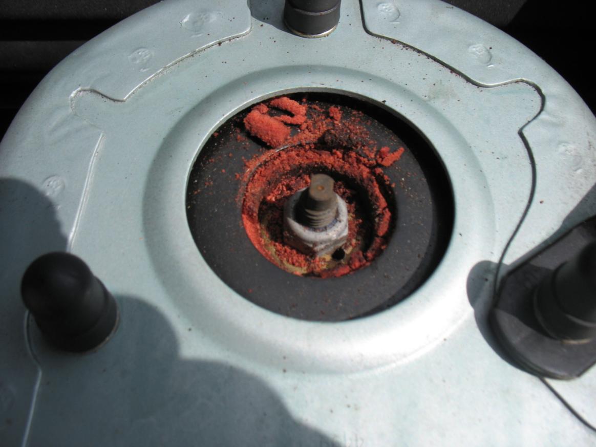

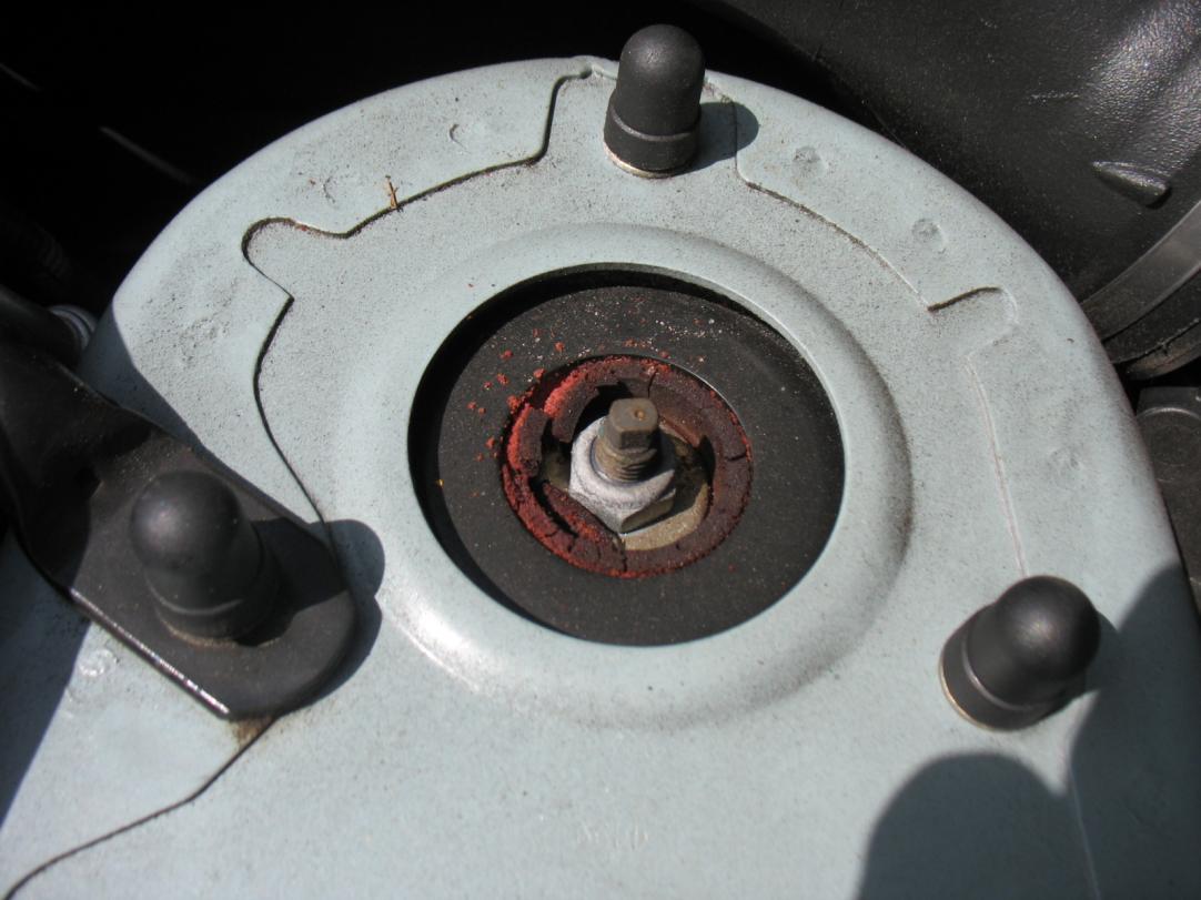

Hello to all!New to the sight and have no clue as to how to post a picture as of yet.Have a sweet SeaFoam Green 2000 XK8 convertible with around 43k miles on her now that is giving me the shakes.From around 50-65mph.I found if I go 70mph or more it calms down,but can not afford the red lights in my rear view mirror ..
I opened the hood and seen that the tops of my front original shock mounts have all but crumbled away.I have done a lot of hunting for this front shock top bushing.
My tires at the time are a little more then half gone and have worn great I might add.So with out me checking any of the front suspension as of yet,I am thinking I may have caught things in time??From my 4 hours of hunting online i found the top front shock oem plates for $177.00 each.Just wondering if going stock again is the way to go?I seen folks on Ebay with the bushing kit with rivets and all and i have to rebuilt them for $145.00 I think it was??But was leaning towards the OEM plate complete so i am not rebuilding parts.Wondering your thought?

The shock mounts are worn but they shouldn't cause the shaking. It should be noisy when going over bumps. You could try rotating your tires front to back and see if the shaking moves. Sounds like one of your tires is out of balance.

If you've done your share of research in the xk8 area, you'll see that those upper shock mounts fail with age, not necessarily with mileage. What happens when they crumble and 'squeesh' is the front begins to drop lower. That additional weight difference front to rear just accentuates any crack, groove or desire to pull one way or the other. In addition, with the front end lowered, that increases the negative camber even more, resulting in more pressure on the inside of the tire, and that again...can exaggerate any road feature pull. Get the upper mounts replaced for sure.
