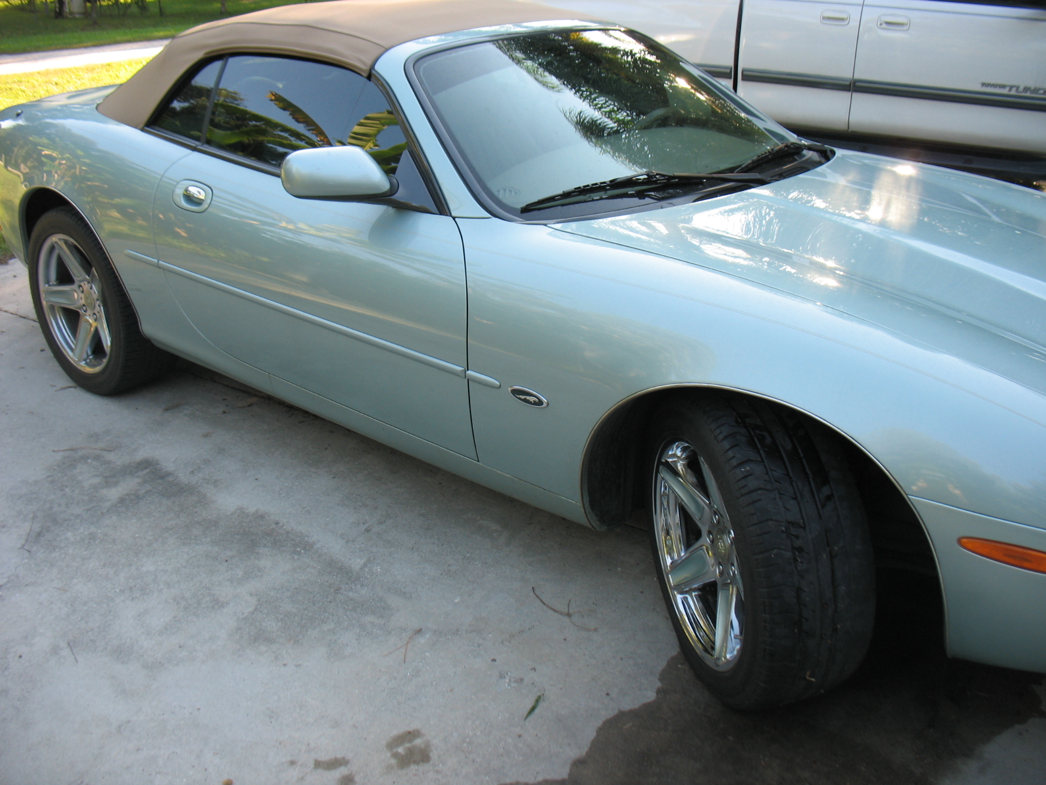

New member.2000 XK8 Ragtop.With a good shake at 50-65mph

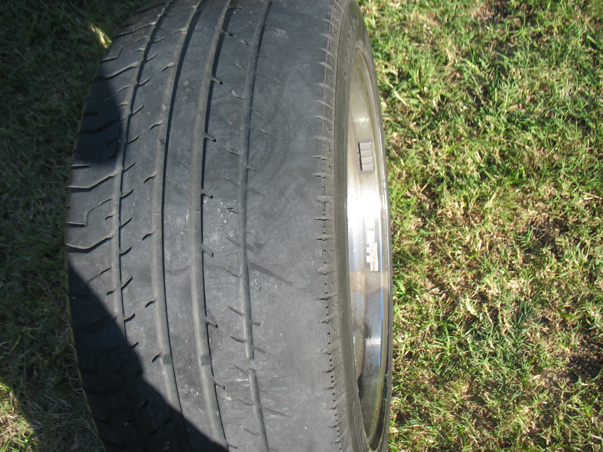

I had also said that they had worn fine.WRONG.From what of the tire I could see with them installed,they looked fine.When I removed both front tires yesterday to clean the wheels and inspect the brakes.I seen that the inner tire is worn off bad of both front wheels.

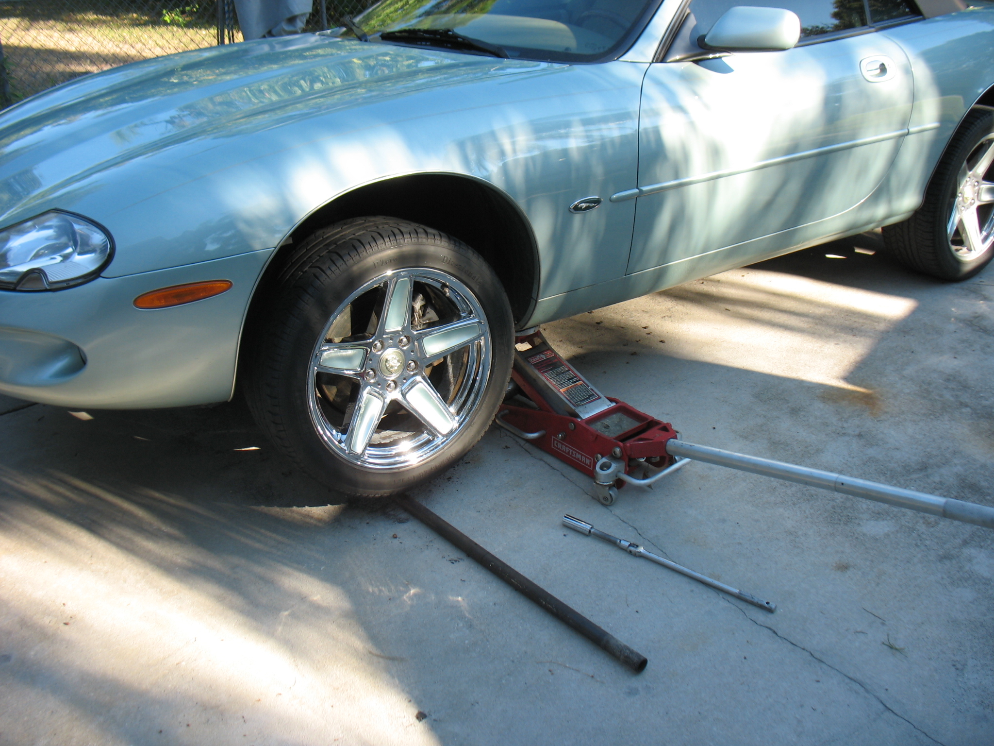

Also I found the cause of what may be some or all of the BAD SHAKE in the steering wheel at higher speeds.
With the front side of the car jacked up,front wheel installed,hanging down less then a foot off the ground.I put a long steel floor jack handle pipe under the front tire.With the 4 foot long pipe slid a foot or so under the tire and me pulling up on the other end of the pipe,checking to see if I can raise the tire up at all and feel or hear any loose play or clicks.I was checking for any worn out ball joints.Well on the drivers side I could not get the tire to budge.Everything was solid.Then when I went to do this on the passenger side guess what??
First I noticed the tire would go up about 1/4" and make a click.And then when I let the pipe loose,tire would go back down,click.
I had found it!! Now I just had to pin point what it was that the dealership could not find!!
I kept prying up and down with the bar and finally had to go turn the steering wheel to the far right so that I could try to see what is loose.
ANSWER TO FRONT END SHAKE AT HIGHER SPEEDS THAT CAUSED STEERING WHEEL TO SHAKE LIKE HE!!.
FRONT LOWER SHOCK BUSHING ON PASSENGER SIDE.
Note:this may only be part of the cause.
This is a real simple check that anyone with a stock car jack and some type of long 4 foot or so pry bar can do without taking the car to the dealership.They will put your car on a lift and look without prying anyways.Unless you have better dealerships then us here.You may??Or if you do go to the dealership,suggest to them to check them out for you.
I would never had known the lower shock bushing was bad just by looking.I am calling it a bushing because it gave off a click click sound as if it is metal.I have never played with a Jag. before so i do not know if once bad i buy new shocks.If it is pressed in or what?My shocks tested out to be fine.
Shame if I have to replace them for that?I hope to remove it and get a picture of it and see what I can do.I may be able to just weld it in some and redrill it a new centered hole?
Now car needs fixed before it gets new rubber or parked as soon as I get home with new tires.Also something is not right in the front end for how my tires have worn bad on the inside of the tread.

One Side Wear
When an inner or outer rib wears faster than than the rest of the tire, the need for wheel alignment is indicated. There is excessive camber in the front suspension, causing the wheel to lean too much to the inside or outside and putting too much load on one side of the tire. The car may simply need the wheels aligned, but misalignment could be due to sagging springs, worn ball joints, or worn control arm bushings. Because load has a great affect on alignment, be sure the car is loaded the way it's normally driven when you have the wheels aligned; this is particularly important with independent rear suspension cars.

One Side Wear

Very nice, that will definitely cause a shake, sounds just like what happened to my rear shock. That bushing just deteriorated leaving you hitting the mounting bolt inside the shock frame. I recommend getting both front shocks replaced (again, will be cheaper than just doing the bushings), those upper mounts will bring the camber back closer to spec, and with the newly mounted tires...you may be golden on your ride issue.
