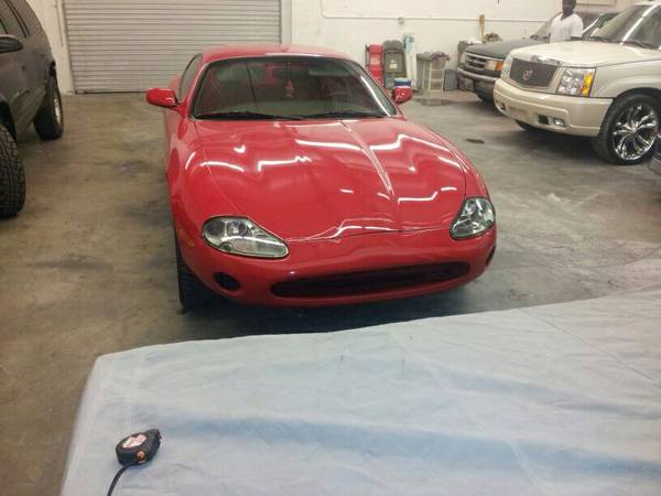

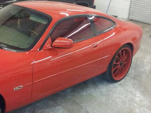

They guy selling it has an auto shop, so it's supposedly in great shape. Should I take it to ANOTHER mechanic or just trust that a mechanic took care of the car. He seems to drive it daily....
I HATE that the windows are tinted red lol, but thats an easy fix.
The interior is in great shape. Is that a good sign?

The forum vin decoder says this XK was white once upon a time?
Anyhoo....... If it was me I would get the car independently checked, just for peace of mind...
And the wheels upset me more than the windows!

If the car was a darker red like carnival I think the windows would not look that bad...... Not fan of the wheels, like I previously said, don't mind the style just matching the body colour looks to much, easily fixed though.....

1) Exterior appearance should be a concern - this is how you identify prior accidents. I don't like the uneven hood gaps, but then again it's hard to tell from the picture.
2) New paint, especially white would not be "needed" unless the car was in an accident. White paint hides a lot of flaws so there's usually no need to repaint it. Unless the prior owner was made out of money the car was probably given a different color only because a substantial part of it was going to be repainted anyway - as a result of an accident.
3) On the early XK8s, regardless of how well it was kept, with 101,000 miles, you WILL be replacing the transmission within the next 30k if it has not already been replaced with a rebuilt unit. This expense will run you $5k, minimum.

I have done colour changes on a few XKs now and they were perfectly fine before hand just a matter of choice, so I would not necessarily agree "as a result of an accident", looking at the shut lines I can see and knowing where to look on accident damaged cars I would say "if" it has been in accident it has been fixed well...
