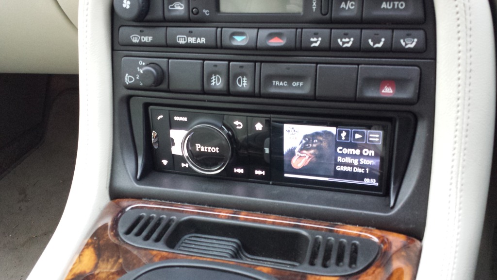

Picture of the installed unit and the album art.

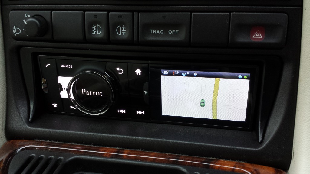

Picture showing the navigation which is also audio turn by turn but in an American female voice.
