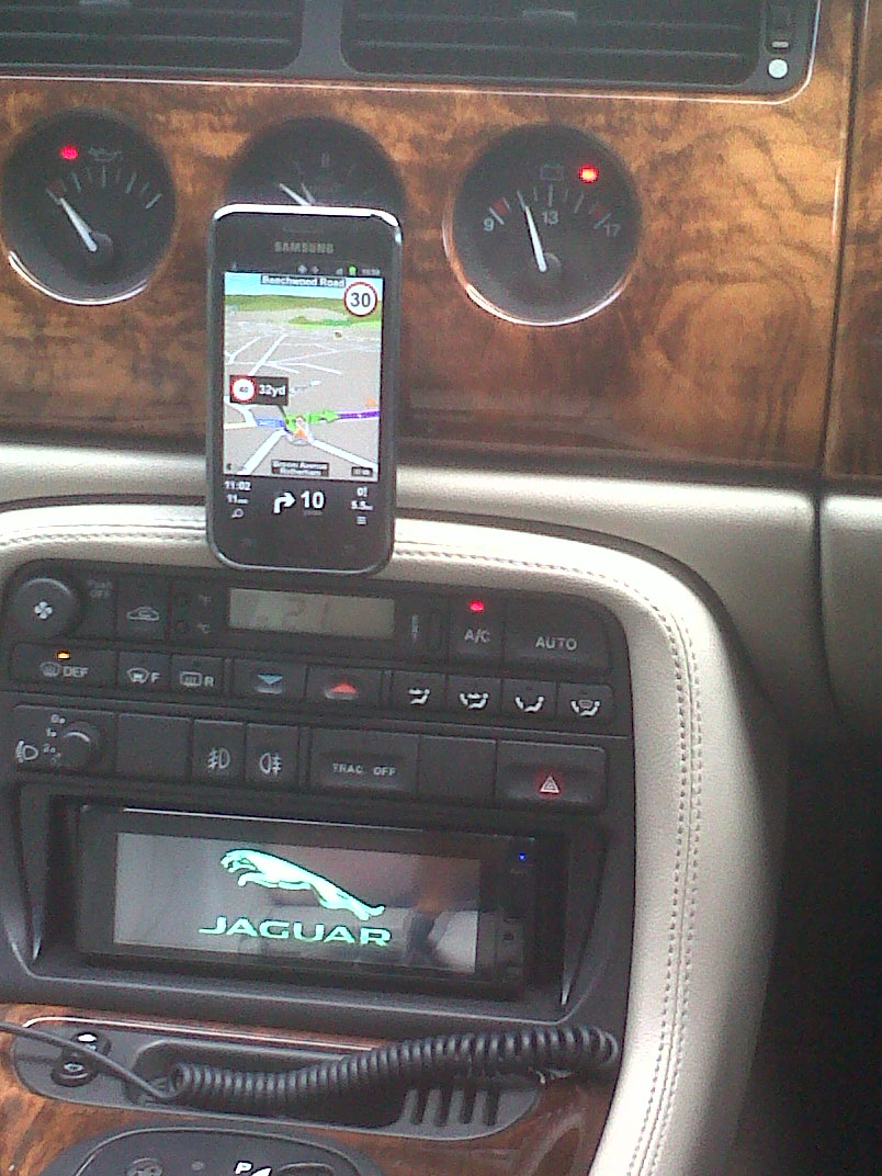

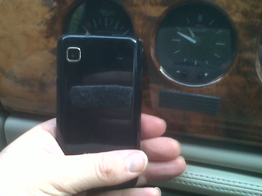

Moving on some of you will have notice the black mark under the clock, Its my patented satnav - mobile phone mounting system - velcro
1999 Aftermarket ICE Upgrade with, ipod, bluetooth, facia and steering wheel controls-img-20131121-00009.jpg
and it works great, no more clunky mounting kits
1999 Aftermarket ICE Upgrade with, ipod, bluetooth, facia and steering wheel controls-img-20131121-00008.jpg
This means I can use a phone based sat nav and by streaming music from the phone to the head unit, via bluetooth, the satnav interupts the music and plays the directions via the cars speakers. far easier to hear than a standalone satnav (especially when topless)
1999 Aftermarket ICE Upgrade with, ipod, bluetooth, facia and steering wheel controls-img-20131121-00011.jpg

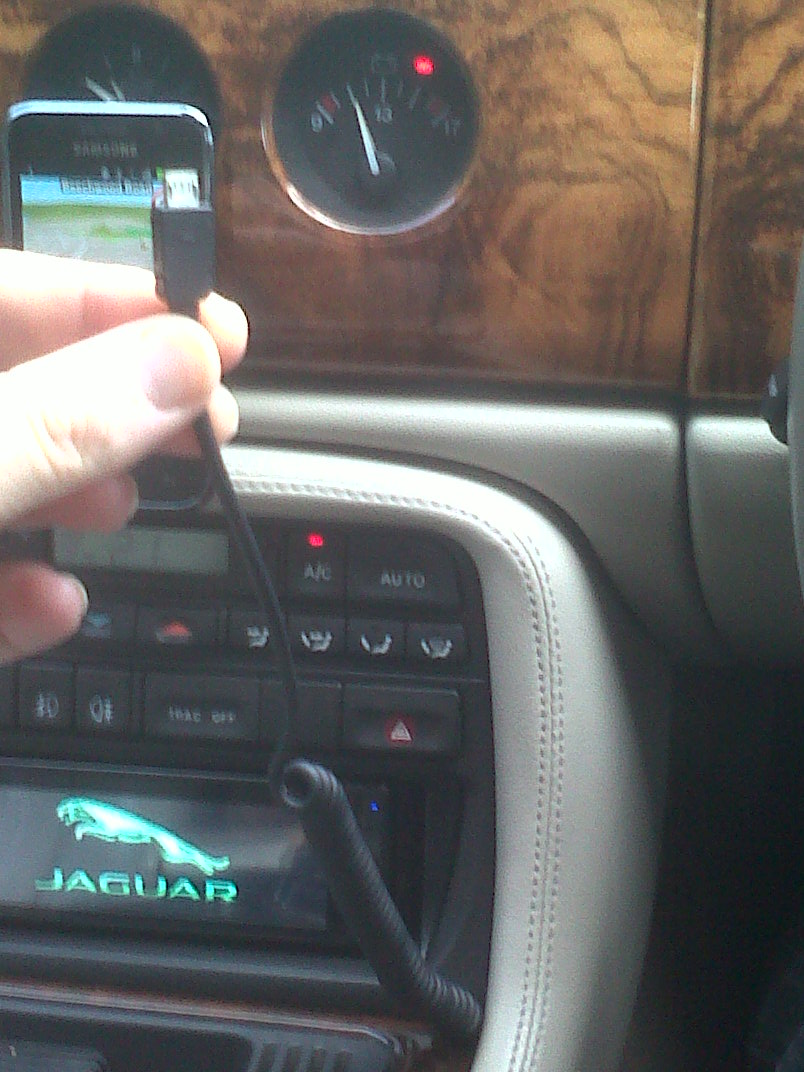

This does mean the phone needs charging on long trips so I installed a 5vDc supply, powered off the lighter feed
1999 Aftermarket ICE Upgrade with, ipod, bluetooth, facia and steering wheel controls-img-20131121-00012.jpg
and that solved it

In case your wondering the sat nav app is Sygic you pay once and updates for life. Far better than my old TomTom
1999 Aftermarket ICE Upgrade with, ipod, bluetooth, facia and steering wheel controls-img-20131121-00015.jpg

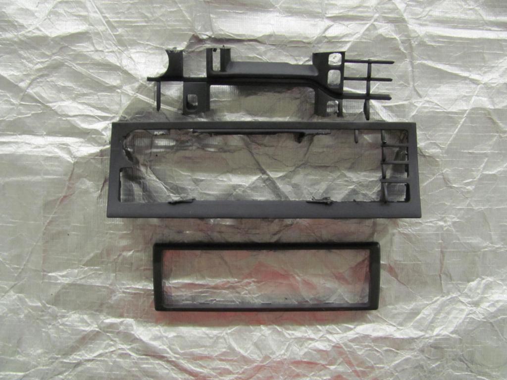

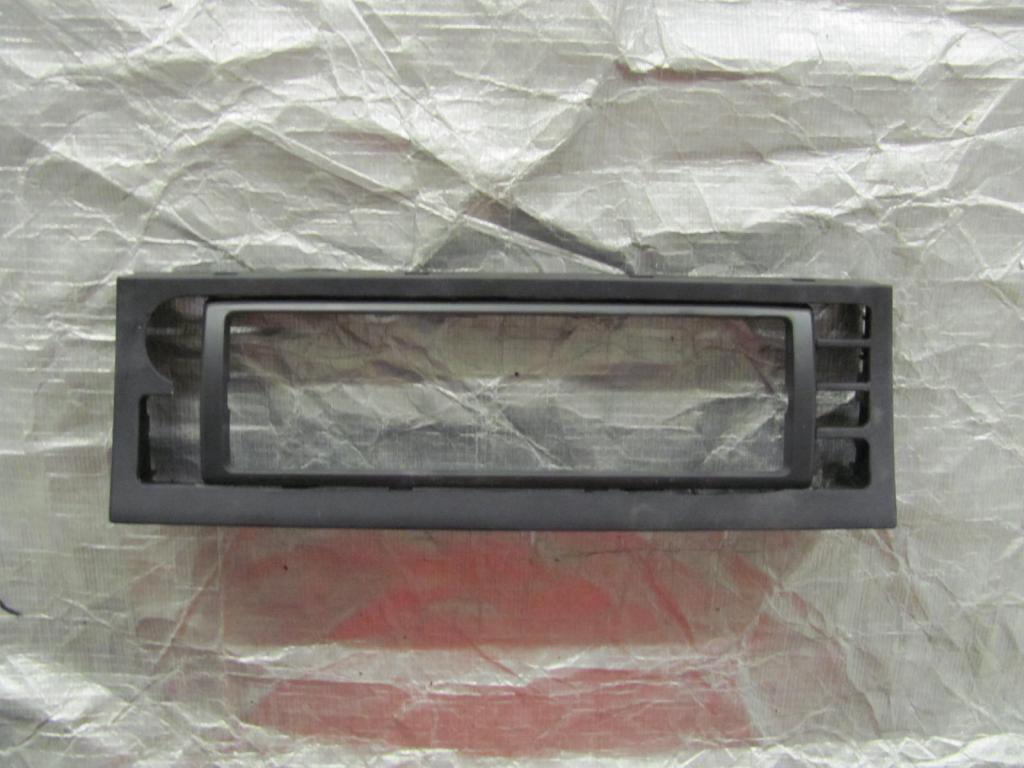

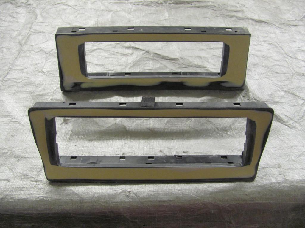

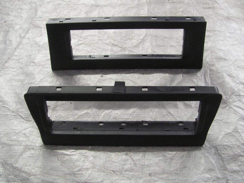

No worries Marc.... It works on both early and later type of head unit and the pictures pretty much explain it...
Remove the fascia from your Jaguar head unit
Then cut the middle out roughly to the size of the new surround that comes with the new head unit
You need to put something behind all the gaps so the filler does not push through, you can use tape, plasticine, anything that can be easily removed
Once filled, paint black
When I make these they are expensive but as I am sure you will understand you are just paying for my time the fascia is free.....
