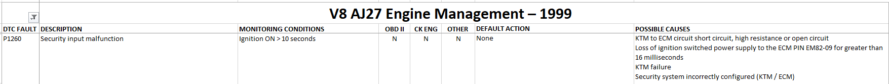

The P1260 will keep throwing until the car is happy with the key.* First move is to reintroduce the car to it as noted above.
*P1260 from DTC list:

Thanks for that.
