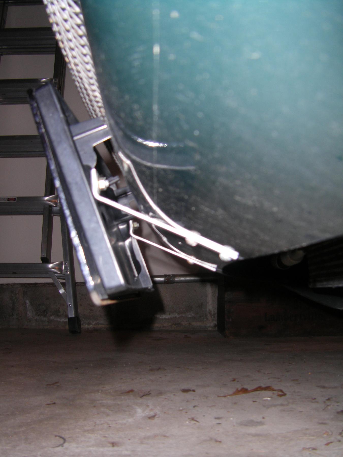

I thought I had photos from the installation on my '01 from a few years back, but no joy. If it would be of benefit, I'll get some from my current '03 in the next few days.
Pretty simple stuff actually. The plastic shell behind the plate is standard XK8 issue. I worked up a couple of curved brackets mimicking the shape of the apron to allow mounting holes to be placed way down low on the apron. Fender washers behind the mounting holes to as to spread out the load. Sized the brackets so the plate extends just the slightest bit below the apron. It's the lowest thing on the front of the car, but just barely.

It would be useful, if you get a chance. Interesting that you used the original XK8 plinth (looking at the photo you posted I could see there was a plinth in there, but assumed it was from some other vehicle).
