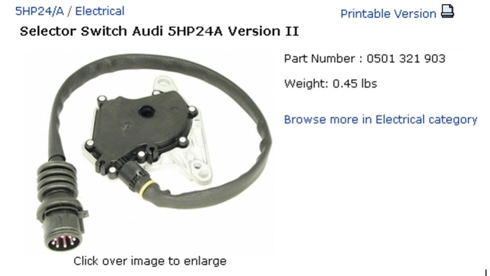

I think this is the switch we are looking for.
Attached Thumbnails No-start due to Neutral Safety Switch-transswitch2.jpg   No-start due to Neutral Safety Switch-transswitch.jpg

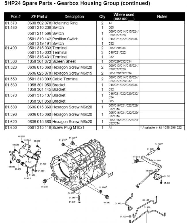

Maybe the 6P ZF isn't mounted to the transmission? Every other swtich i've seen has been.
I can't even find it in the parts list.
I found this to be a great resource;
http://openpdf.com/
http://openpdf.com/ebook/zf-5hp-24-pdf.html
