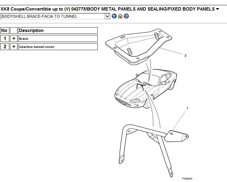

There are a number of braces fitted to the convertible:
(click on the images to enlarge them)
The metal-on-metal sound could be from a loose or even a cracked brace.

Item 1 in the first diagram is accessible from the engine compartment (there's two of these braces).
The dash braces are accessed from inside the vehicle and dismantling is required to get to them.
