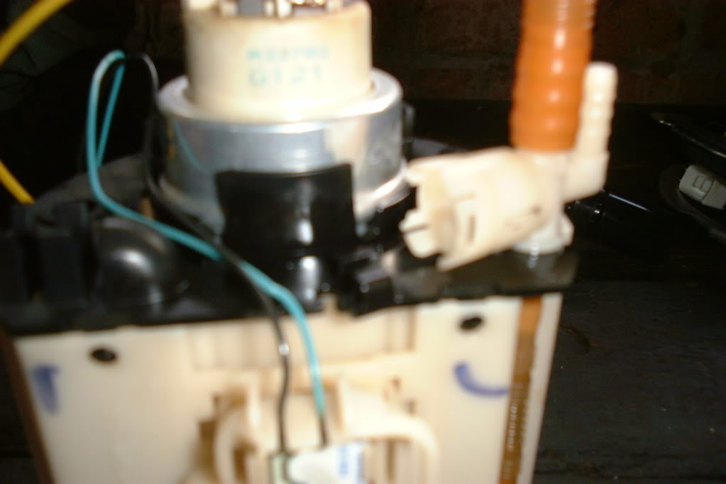

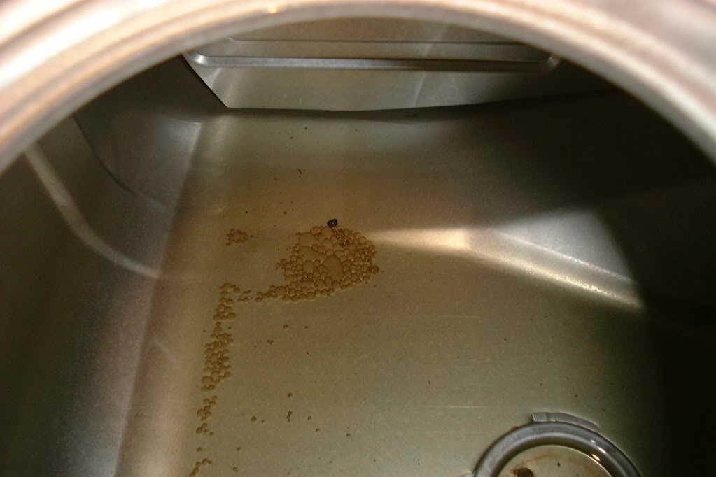

Default Correct Order
Hi Chaps,
The car is surging during power delivery. Max, do you have the old one you could take apart to confirm orientation of the spring?
Originally Posted by XKR
Old Dec 7, 2014 | 06:57 PM
  #49
maxwdg's Avatar
Joined: Mar 2011
Posts: 280
Likes: 70
From: Kansas City Area
No problem man. I'd be happy to help. I still have the old pump assembly on my shelf in my shop. I just refamiliarized myself with the entire assembly so I'm ready to talk with you about it. I just sent you a private message with my phone number. Give me a call. By the way, I remember the little parts laying in the bottom of my tank just like we see in your pictures.... That's not something I'm looking forward to ever seeing again!
