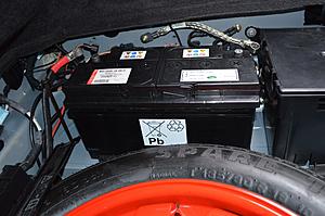

Old Feb 22, 2018 | 09:11 AM
Likes: 17,016
Originally Posted by cjd777
Alan, it's behind the panel on the right side after you take the battery tray out, Right above the radio and amp shelf.
Wayne
I'm always happy to learn something (and regularly do on the forum) but the XK8 doesn't have a battery tray. Also the RH luggage compartment trim panel is above the battery and can be removed without taking the battery out.
Please post a photo of this second diagnostic port you've found because I've never spotted it.
Old Feb 22, 2018 | 09:16 AM
Jon89's Avatar
Joined: Jan 2009
Posts: 13,083
Likes: 4,740
From: Raleigh, NC
Graham,
I think Wayne meant the battery cover, not the battery tray....

GGG, That was a unexpected facetious remark. The battery/spare tire cover (tray) covers the lower edge of the carpeted edge on my XK8 for that side panel and is much easier to extract and replace if the cover is out of the way.
Wayne
