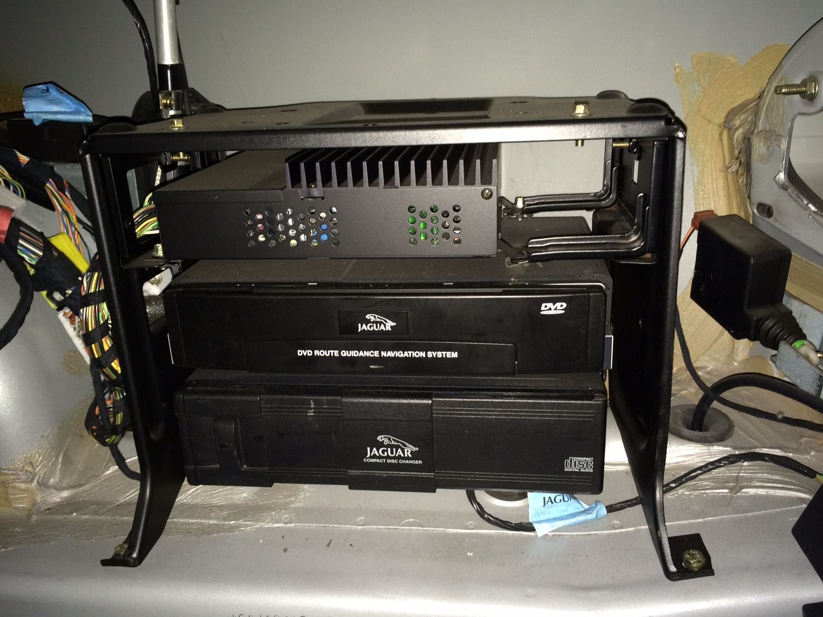

A quick update having spent the evening in the garage. I took the centre console out and the radio/switch cluster. Discovered there weren't sufficient connectors there so went to look for the amplifier in the boot. It's above the navigation system if you remove the liner on the RH side. The photo shows the wheel arch in the bottom left corner, which should give you your bearings.
From there on it was quite straightforward. Unplug the two leads in the side of the amp, insert the SOT lead from Nexxia into the amp and plug the original leads into the other side. That gives a break out loom for the Parrot kit so plug the (Parrot) ISO leads into that.

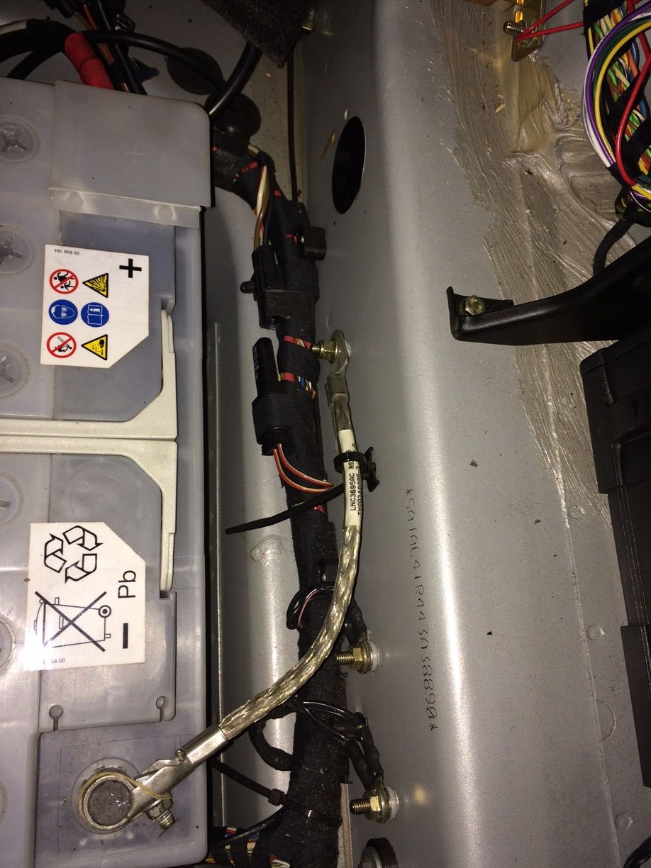

The only remaining issue is I still don't have a power source switched from the ignition. I can't find the auxiliary power connector in the boot. There are some connections to objects that I don't recognise and a loose connector behind the battery close to the bulkhead that has two unswitched power connections. I've attached a photo in the hope that someone can point out the AUX connector (which could have something plugged into it).

It is the connector with the three wires: Brown, Black, White with red stripe taped beside the battery in the first photo. It is mated to an empty shell.
You will be able to get battery and ground from it, but for switched power, you need to add a relay in the empty position in the boot fusebox.
Also, for the streaming audio feature, if you are happy with the sound, then great. If you are not, it is probably because the ISO connectors bypass the power amp, and you are driving the speakers with the little amp in the Parrot. To resolve this, you need to provide an auxiliary line level input into the headunit, and let the original amplifier do its job.

Great, I was wondering about that one but hadn't realised it was plugged into an empty shell. Can you confirm that this is the relay I need? Jaguar BROWN RELAY LJA6703AA **Buy One Get A Spare FREE!!** XJ6 XJ8 XK8 X350 | eBay

I tapped the white with a red stripe lead and it was indeed the switched supply. Strangely, it worked without a relay in the missing space. Everything now working but the Parrot CK3100 kit doesn't play Bluetooth audio (which is fine, I wasn't expecting it to). Thanks again for all the help.

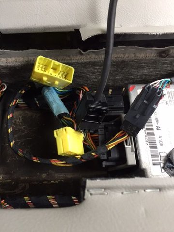

Attempting to install a Parrot mk9200 in '02 XKR with handset. Going to got for the splice option and I think I've found the correct harness. However I'm stumped on which one to cut? Male pins or female receptor? E.g. Top or bottom one in pic?
