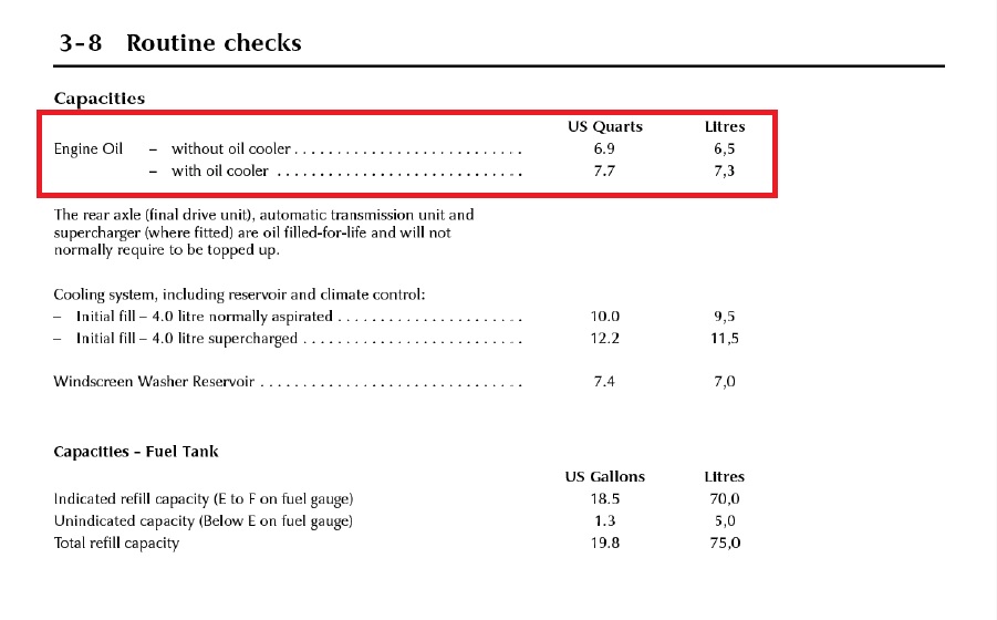

Planning an oil change on my 2000XK8, I like Amsoil 5-30 for this car I just don't know what the crancase capicity is plus the filter. Only had the car for abt 3 months.

I'm going to say it's around 7qts, I just fill mine until it's in the right place on the dipstick, never measured it.

our nice friends at SNG have it listed as 6 - 7.8 litres.

The 2000MY XK8/XKR Vehicle Care Handbook gives:
