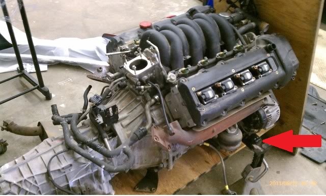

hey forum, been layed up a while had a pacemaker put in (me not my car) can anyone tell me where my oil FILTER is on a 2001 xk8 convertible.... can't do any work on my car yet but gona have to tell my mechanic where it isssssssss................... thanks tony

First you need to remove the plastic cover under and behind the radiator. The filter is then exposed on the right front corner of the engine.

Tony,
I hope your ticker is keeping good time again.
Oil Filter arrowed in red:

Obviously the best method to remove the octopus hose and Norma connector.

thank you test point...thank you GGG .......... and tks for the good wishes
