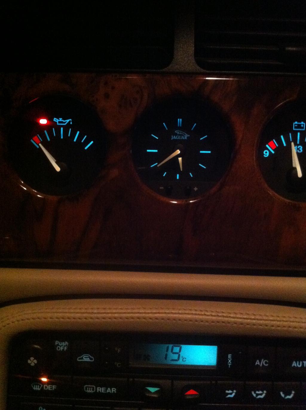

Hi. Now im driving in the dark here in the uk i have noticed my oil pressure light is always on.
It never goes out when the ignition is off it still stays a light. Here is 2 photos of the light

The light never goes out when you start the car it goes bright then after a second when the pressure goes to half way on the dial it dims to the other picture i took.
Any help

In both pictures the gauge needle is setting on 0 indicating that you have no oil pressure or a failed sensor. The sensor is only a contact closure at about 7 psi. With the contact closure required to extinguish the red light I would suggest that you resolve that before tearing the instrument panel apart.
The second picture might indicate that the light stays on with the engine off as the VM is at O. Is that the issue?
Some oil filters that are sold for the XK8/R do not have a back flow valve allowing the oil to drain back into the engine when off. That causes the oil pressure to stay at 0 psi for several seconds before the filter fills back up. Does that relate to what you are seeing?

Hi, the pressure is fine and goes half way about 1 second after i start the engine and the light then goes to the dim light. In both those pictures the engine isnt running.
basically what im trying to say is the light is always dim without the keys in or without the engine running then when i turn the ignition on it turns bright red then when i start the engine it goes back dim about 1 second after when the oil pressure is at halfway.
is there a ground wire somewhere that is making the light stay on, thats what im thinking? its a worrying light to have on

Well the oil pressure gauge is nothing but a check light also, it does not read actual oil pressure. The oil pressure gauge is showing what the ECM thinks is the oil pressure. There is no oil pressure sending unit only an on/off switch. The fact that the needle moves at all proves that you have oil pressure and the change in light brightness seems to verify this.
My guess is you have a short somewhere I the oil light circuit, have not looked at the electrician diagram but most of the indicator lights short to ground to come on.

Check the red/white wire that runs from the yellow connector on the speedometer cluster to the connector on the 3-gauge cluster for damage.
If you decide to unplug any connector, be sure to disconnect the battery first.
