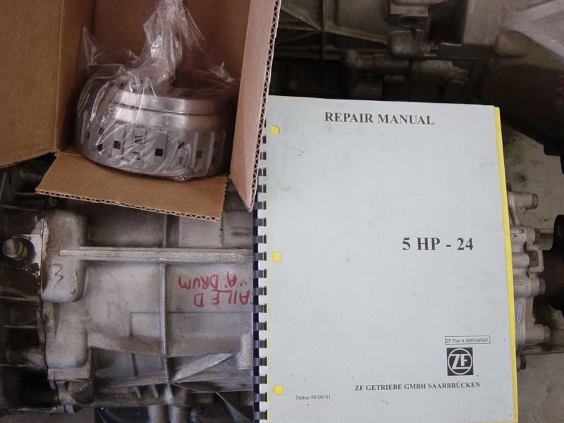

Just bought another 'A'drum for another 5HP 24 repair. The ZF repair guide is good info and they are available on eBay and other sources.
bob gauff
