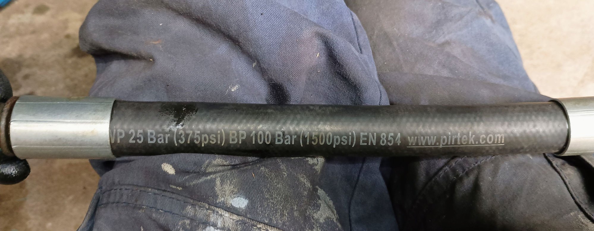

Hey Jack. The guy I used knew more about hoses than I will ever know so I let him make the decision as to what hose to use.The only concerns I had was the hoses had to pliable and exact which they were making everything go back together a lot easier.. All I know is they are nylon braided and rated at 350 psi sorry I can't be more helpful.
Cheers!
Andrew
Old Sep 17, 2024 | 03:51 AM
RaceDiagnostics's Avatar
Posts: 1,854
Likes: 987
From: UK
The oil lines top out at 7 bar so pressure is not too high. This is the hose my shop used.

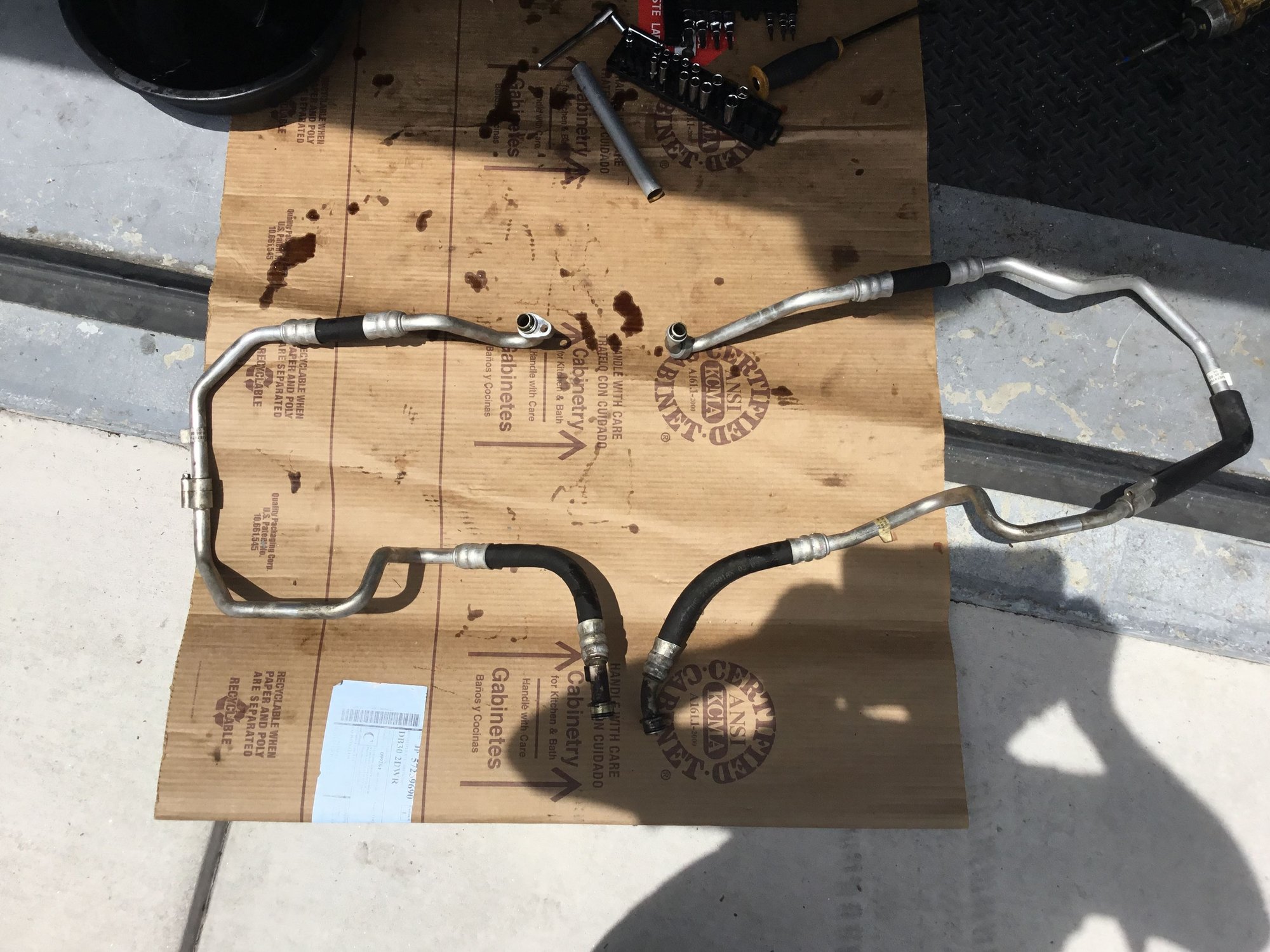

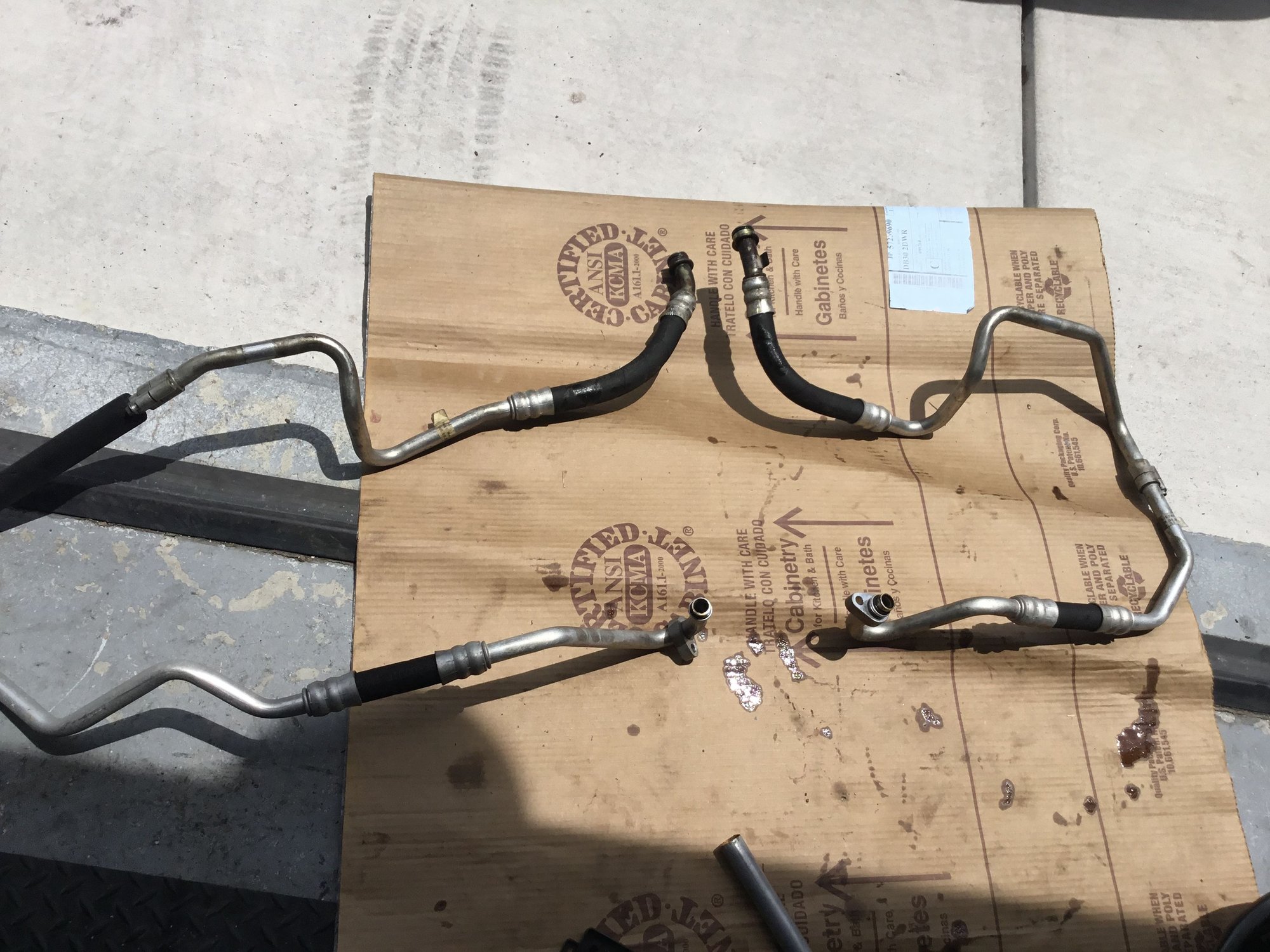

I thought a picture of the lines might be helpful for some that need a visual reference. This is what they looked like upon removal.
It is a messy job no matter how careful you are.

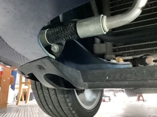

UPDATE on my oil line replacements on the 2003 Coupe. The original crimped ends were removed and new readily replaceable ends were add ed by local certified welder at request of the Hydraulic hose repairman. He used quality Ag. hoses and had over 30 years experience. The slip on ends only required a special geered clamp with indicator to located the proper mounting location on each hose. We reassembled the new hose onto the renewed ends with a lube that appeared to be S.T.P. Andy Granatelli would be proud. No leaks and easy job. The Ag Grade hoses will outlast the car. Total cost incl. the new O-Rings $240.

I like the idea of hose clamps and new tubing ends as the job will be a no brainer next time. Hopefully a very long time from now.
