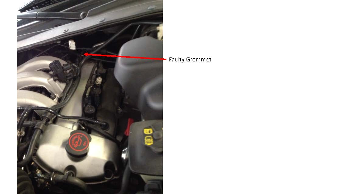

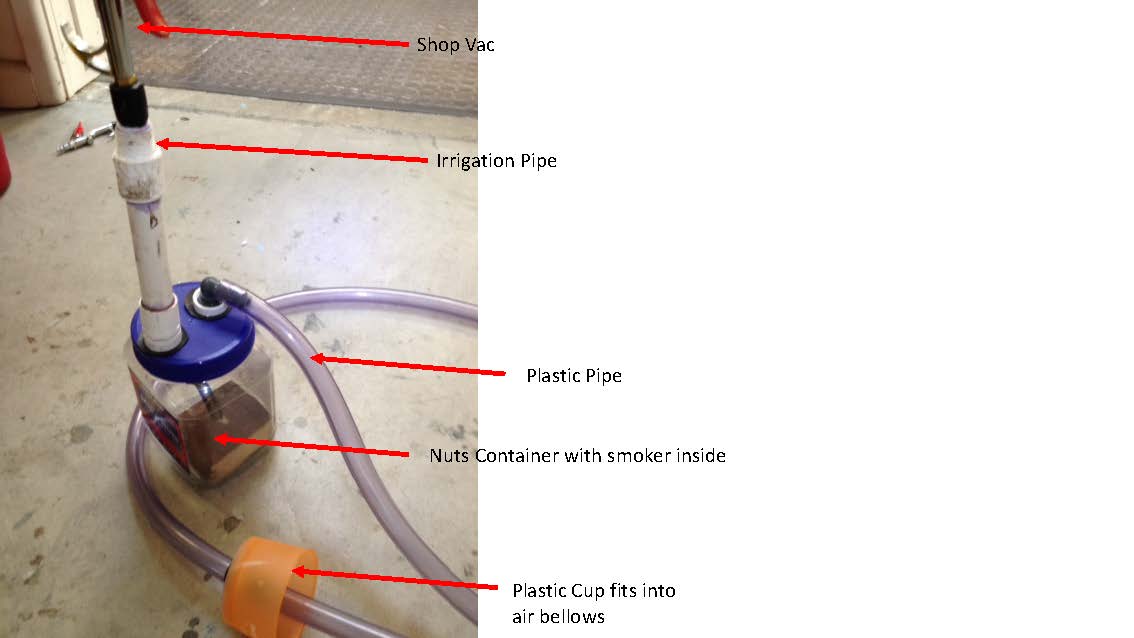

My problem was on my Jaguar S-Type, 3.0L 2000 with 144,500 miles. I got the Codes 0171 and 0174. As my car has always been spotless (I keep the engine very clean as well) and as all the hoses look like new, I was convinced that I had bigger problems than a vacuum leak....however I DID have a vacuum leak. Here the details:
I built my own smoker with a plastic nuts container (see attachment). Blew air into it at low pressure with my shop vac. Made smoke with a small smoke pen (used by contractors to detect airflow in houses). Worked well.

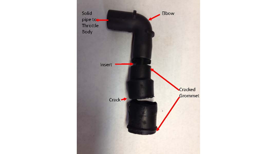

Then I noted smoke coming from the rear of the engine (between engine and passenger compartment). On investigation I found a rubber grommet which was totally disintegrated. The pipe is attached on the front end at the throttle body, passes over the engine block to the rear end, through a 90degree bend, then fits onto a larger pipe facing vertically down behind the engine block (note: I am not an expert, just a retired businessman).
So I replaced the rubber grommet (I had to make my own, as I could not get something to match from local spares shops). The grommet has an approx 10mm opening on one end and about a 20mm diameter opening on the other.
I have attached a few pics to show where I found my vacuum leak. Again I did not believe that any of my hoses were in bad condition, but was proven wrong.
