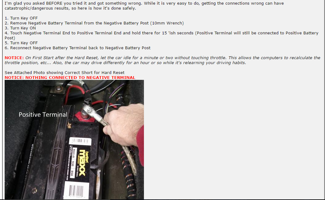

Check the Battery Voltage should be around 12.5. if it is around 12.5 then do a hard reset
