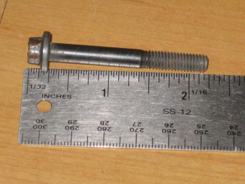

Oooch yes I check my spark plugs and found a few loose, 2 were hand tight. I've fixed that but same problem still existed. Now I have a genuine Jag MAF (tired 2 Chinese ones first long story ) so fingers crosses.
I also decided to track down where the bolt I found on top of the gear box was from. Just finished taking throttle body and EGR valve out (bolt was top one from EGR valve) cleaned all elec connections and throttle/EGR valve. EGR valve between inlet elbow and valve had been leaking air (cos missing bolt) so I'm hoping STFT/LTFT/Rich condition will be fixed. But who knows!!
Reset ECM again. Need to take it for a long drive but its raining here in CA so will wait till tomorrow.

OK new MAF from Jaguar got the MPG back to 14.5 MPG and putting the bolt back in the EGR value and good clean of throttle body has got me to 17.5 MPG.
Bank 1, 2
STFT (mean) 0.38% & -0.56%
LTFT (mean) 5.85% & 4.67%0
after 15 mile drive on freeway @ 70 mph
I have never got that MPG. Jaguar dealer did the EGR pipe back in 2004 just after I bought the car my guess is the bolt has been loose since then as the bolt head was rounded, so they must have removed it. That really sucks loosing 3 MPG for 30K miles ($1200 in fuel wasted)!!
Thanks Jag dealer !!!
