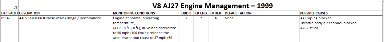

No experience, but the DTC list gives you some possible causes:

AACV is bolted onto the throttle body. it's an old japanese trick to improve cold start emissions by routing air from the throttle to the injectors. you're going to have to gut another throttle body to get the part you need
