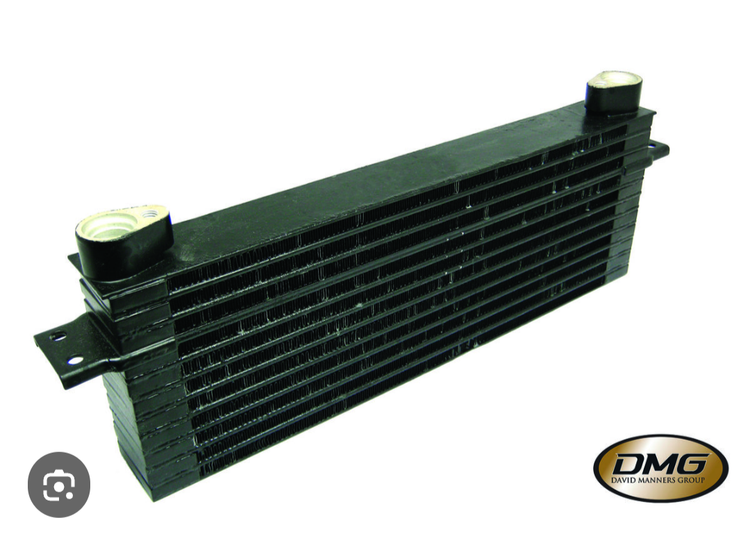

Has anyone successfully fitted one. I've been looking at the pics on line and it seems like the orientation of the pipe connectors boss is wrong. The aftermarket units have the hold down bolts pretty much running down the centre line of the cooler rather than offset on the original. I think this would put a lot of strain on the cooler hoses.
Any thoughts?

I don't remove the lines very often but the one's I have in my spares pile have 'swivel' type hold downs that can be oriented any way needed.
The 'oval' hold downs are separate from the pipes.
Ahh, so this part swivels, I can't remember if that was the case on mine or if they were just a bit sized.

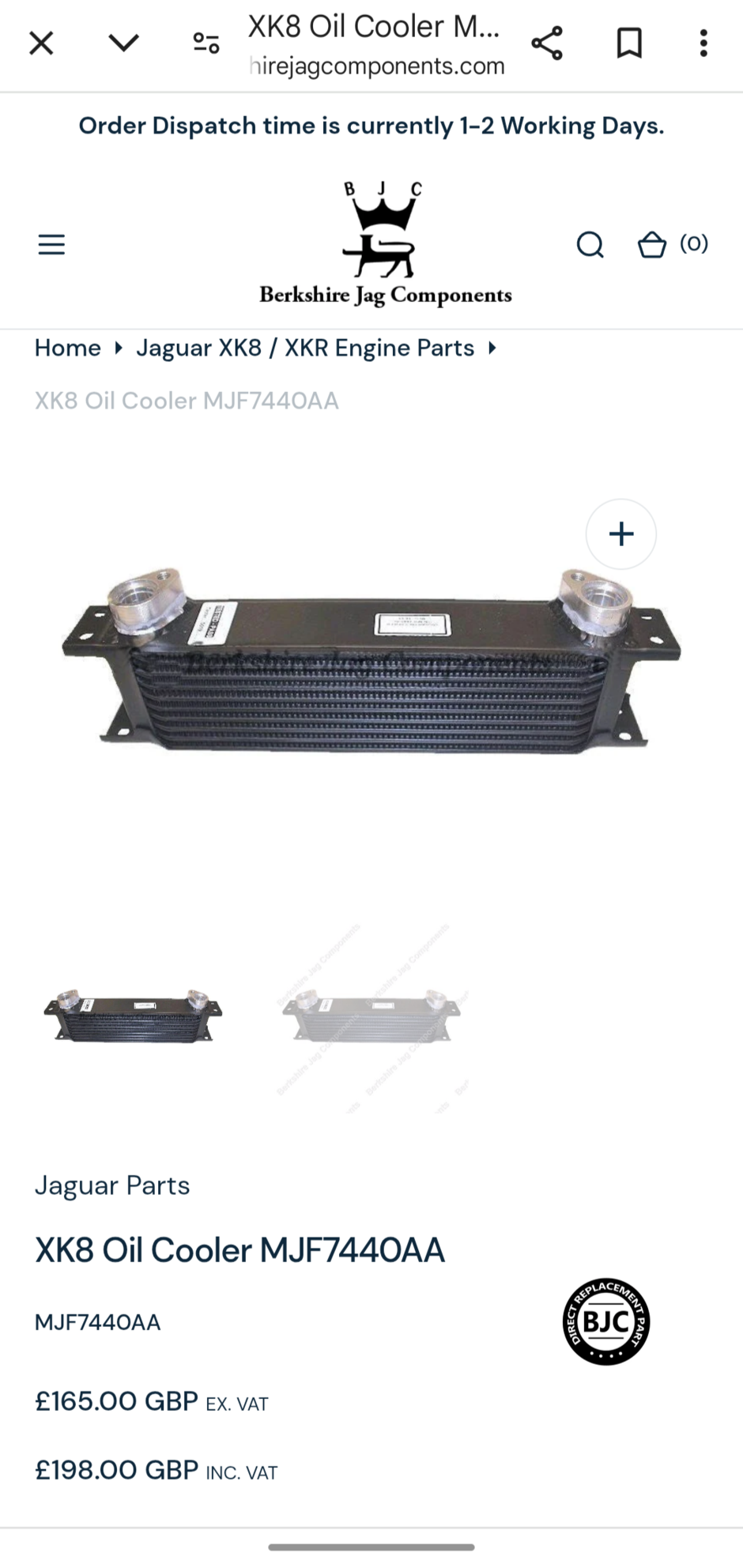

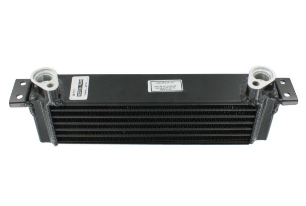

Just found this aftermarket one. I called them and asked about the boss orientation, they said theirs is identical to the original and that it's not a "stock" picture. They said it was in fact manufactured by the original Jag supplier. Just not Jag branded. Not cheap but still a lot less the the Jag branded ones.

The Berkshire Jags aftermarket unit looks pretty good. I'll get it fitted tomorrow. It was about £200 Inc shipping and tax.

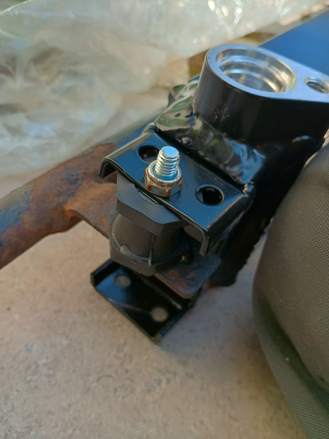

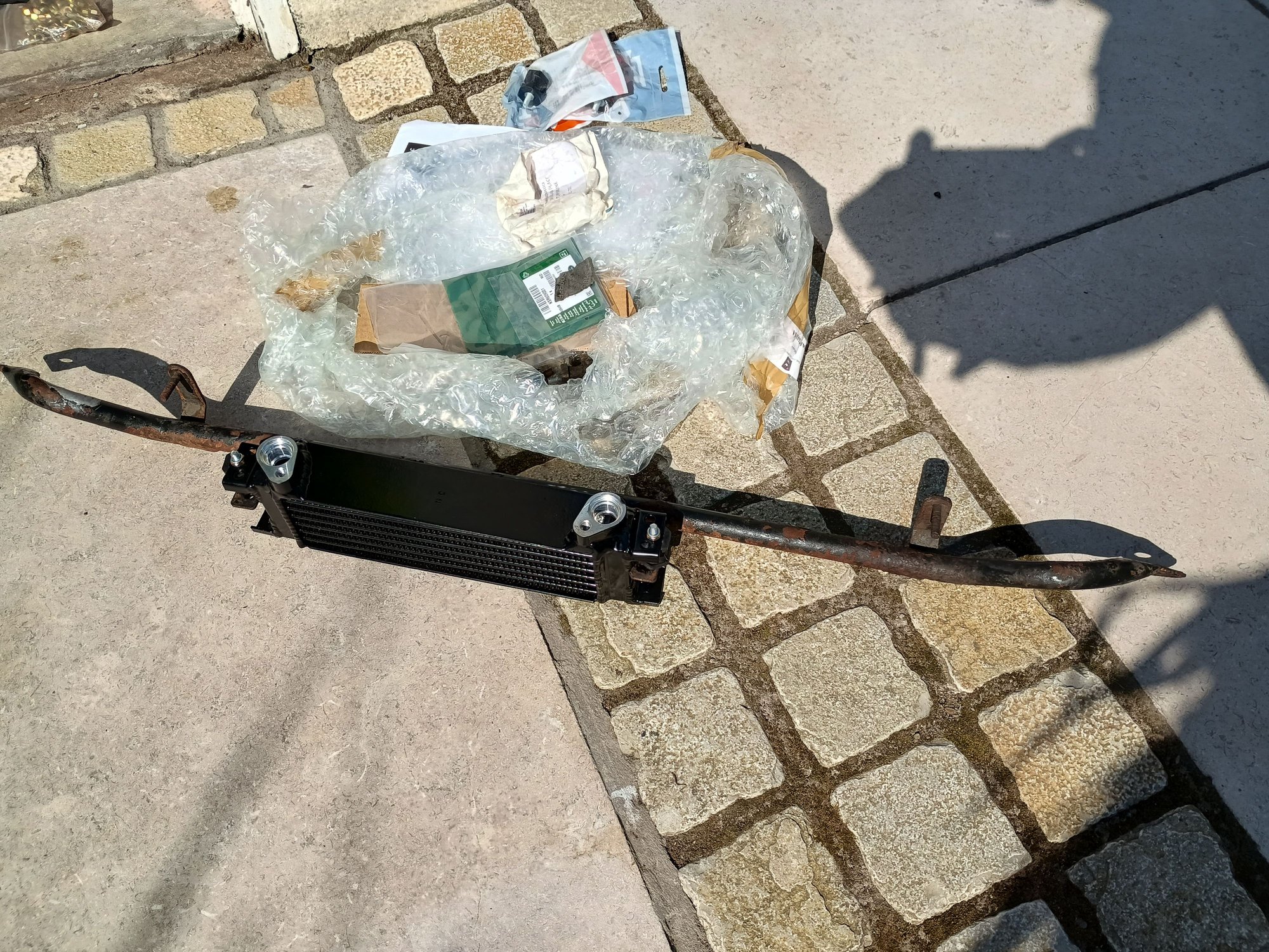

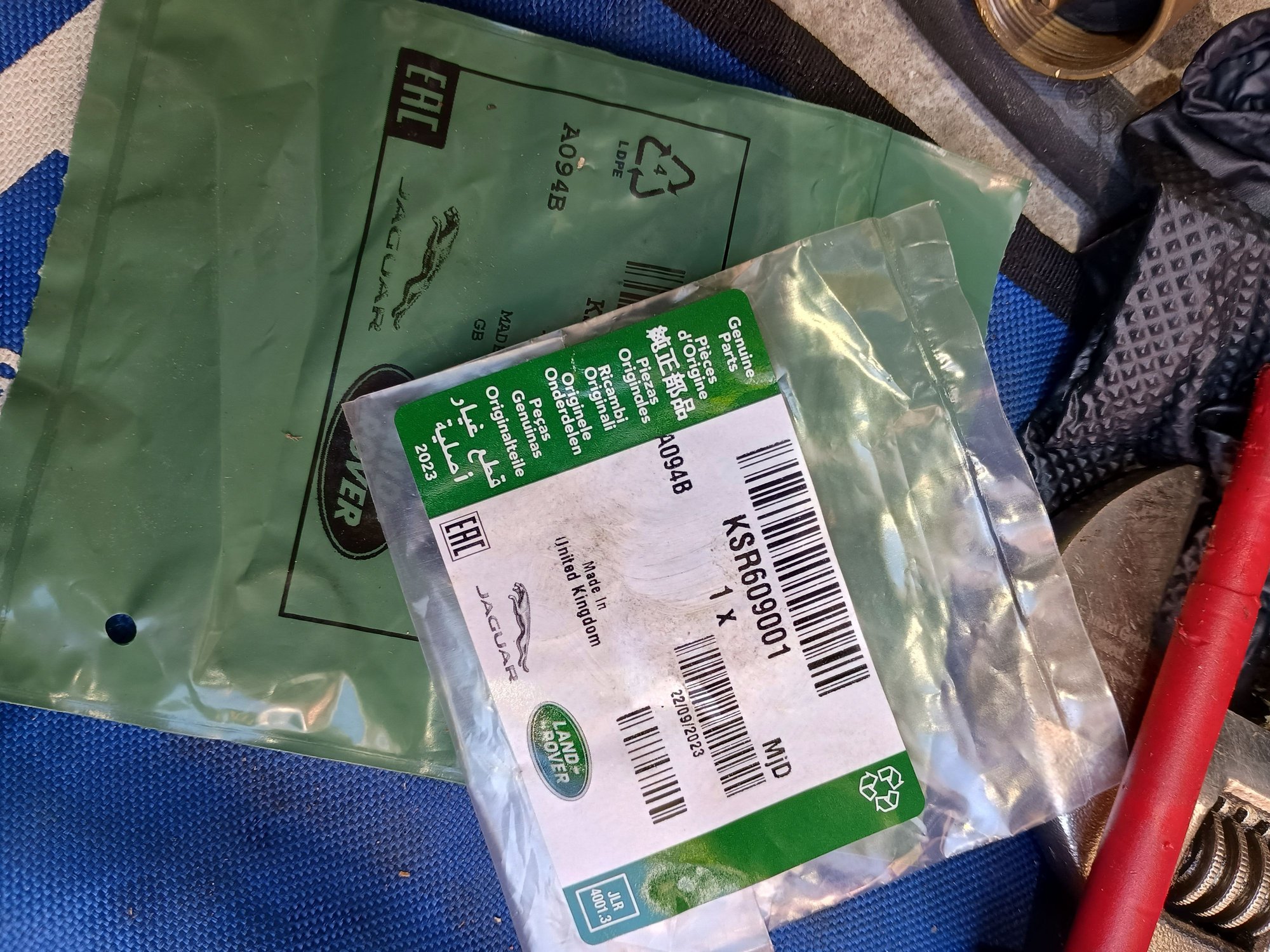

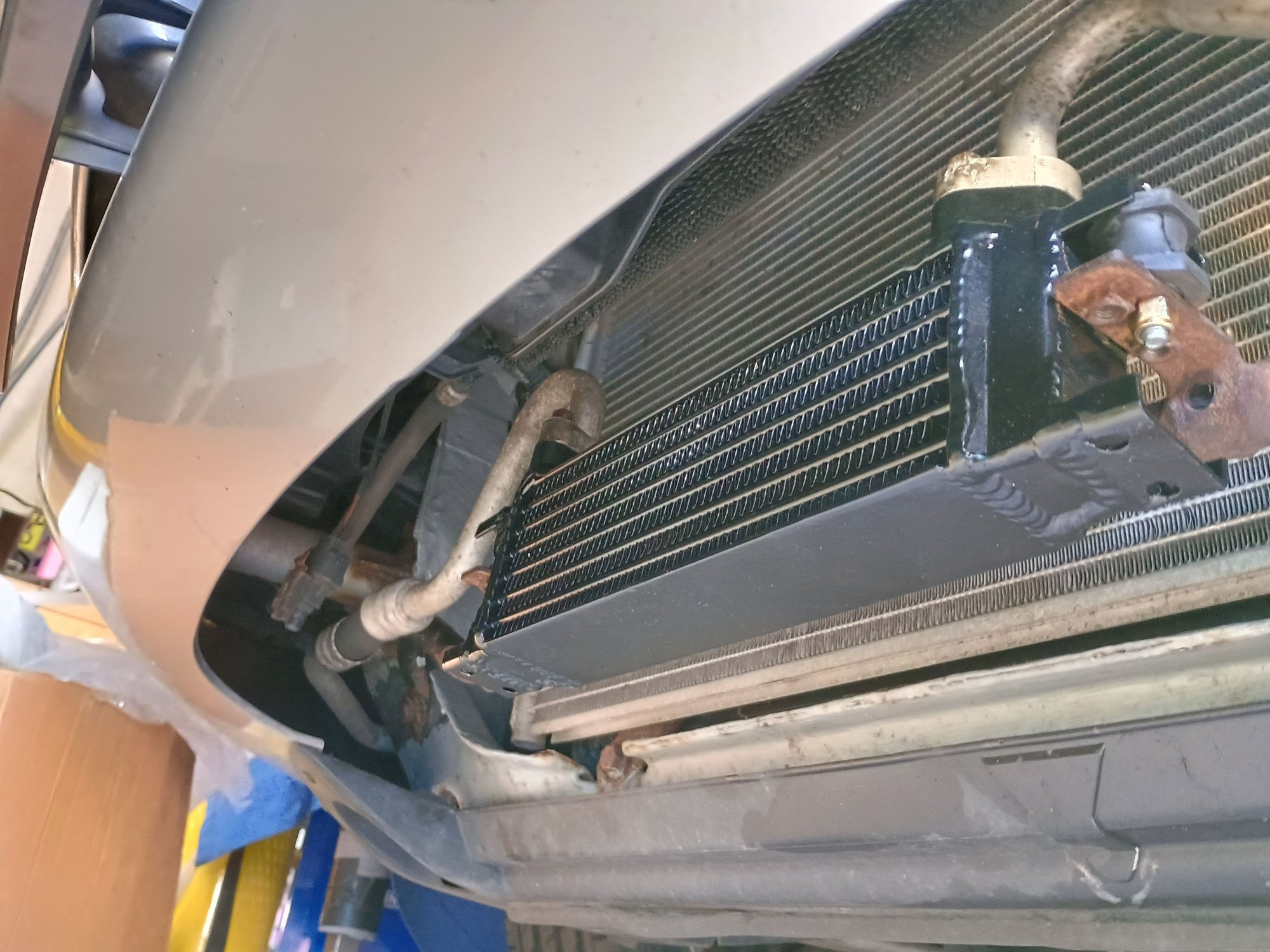

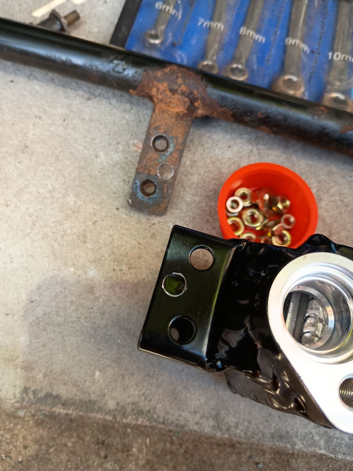

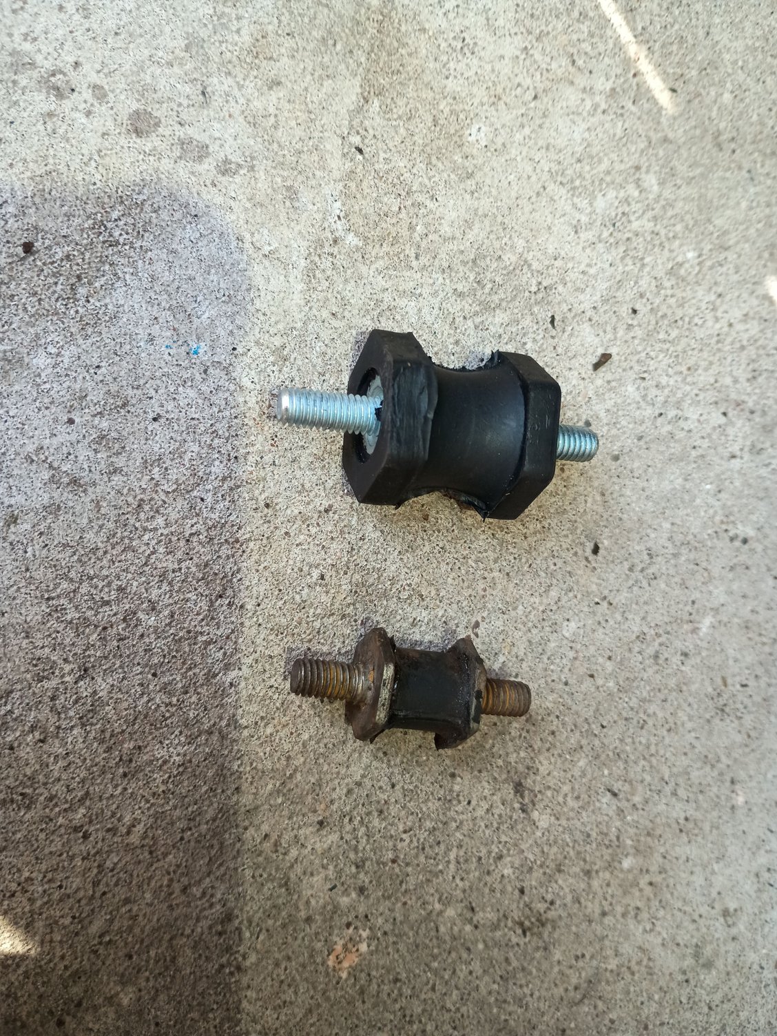

The rubber mounts I had to hand are larger than the original so I drilled a couple of extra holes in the cooler and support bar.
Fitted together.
New O rings.
I topped the new cooler off with oil and refitted. Job done.

Looking very good.
