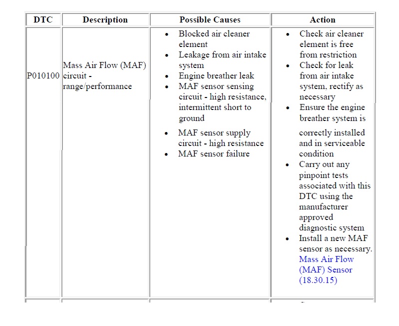

P0101 has no extended codes. It is simply the following:
On a regularly serviced vehicle, a blocked air cleaner element is possible but not very likely. The most probable cause would be an air leak folowed by harness/connector fault and then MAF failure.
There's a line between fault diagnosis and guesswork. Accurate diagnosis leads to a successful resolution; guesswork leads to the Parts Department.
Three attempts with new parts and wrong each time. Ground fault or out-of-range MAF signal is looking like the next option unless they go straight for the jackpot and sell you a new vehicle.
