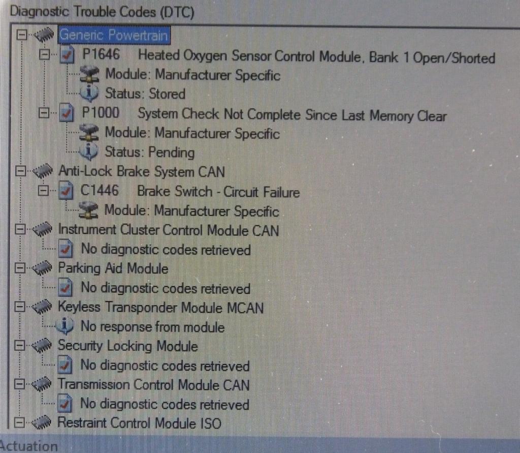

Here is a picture (sorry for the poor quality) of the screen report:
http://i1055.photobucket.com/albums/...ps214cdd9d.jpg
So, it looks like P1646 seems to be the Engine Check Light culprit (would I be right in saying that?) Would it be OK to drive the car (with care) with this error? (basically to take it to a garage, which could be upto 30 miles away)?
I am assuming that this is a simple enough fix, to replace the faulty o2 sensor?
Secondly, the C1446 error code appears to be a faulty Brake Light Switch (which would make sense, as I have been having intermittent "Check rear lights/Cruise not available" warnings for a few weeks now, but never had time to get it looked at.
Again, this seems to be a fairly straightforward fix, in replacing the Brake Light Switch (though appears to be quite tricky for a novice to do, so I will ask my garage to do both fixes).
I am assuming that the P1000 is because the Auto Enginuity was not able to do a complete scan (something to do with having to short pins 7 & 15 to complete the scan)...but I think that is more an interface (AE) problem, and not my car, so I am not too concerned about that, for now...
So, any advice would be gratefully appreciated, but would what I think be the likely culprit for both of my faults?

P1000 is not a Trouble Code. It means "Emission Monitors Not Complete".
P1111 is Emission Monitors Complete".
After Clearing Trouble Codes, P1000 will be set until a specific Driving Cycle has been completed.
After the Driving Cycle is completed, P1111 will be set.

This is a pretty good thread on this issue -- P1646 Error Code: Which Oxygen Sensor Do I Replace? 2002 X-Type 2.5L - Jaguar Forums - Jaguar Enthusiasts Forum
You can drive it with a bad o2 sensor, as far as I know.

Use this link to translate your codes.
Link for “P” codes http://www.jagrepair.com/DTCforms/X1...C_OBDII_R1.pdf
Link for “C” codes http://www.jagrepair.com/DTCforms/X103_C_DTC.pdf
