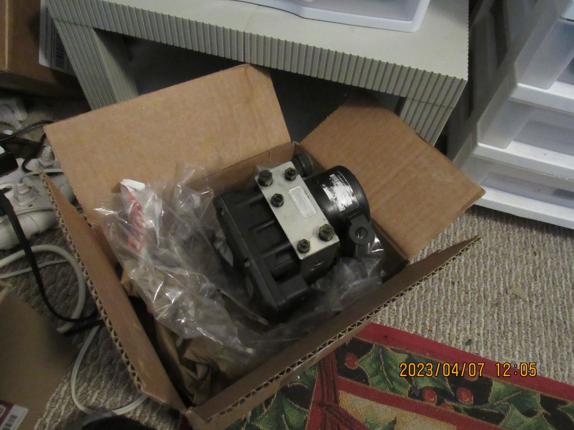

Keep in mind that have to remove the brake lines at the pump to get the module out. The 3-4X I have done it I only lost a couple of drops of fluid, and lightly reconnected the lines during the duration of having the module out for repair.
Is that FAR different that having the lines cut just above their connection points and taking the entire assembly out? I would guess any fluid in there would rain out, but the lines are crimped, so would the inside get dirty/contaminated?

From: Rocklin, CA
Originally Posted by Don B
Hi Ken,
If you disconnect the brake lines from the old ABS modulator and install the salvaged one, you will have to bleed the air from the entire brake system at all four brake calipers. I can't recall if the X100 supports bleeding the ABS module, but if so, bi-directional scan tools can force the pump to run and the valves to open to bleed air through the module.
You can avoid this by just replacing the ABS electronic module by separating it from the valve body without disconnecting the pipes. But check to see if the plastic case of the salvaged module has been sawn open and re-glued. If not, it probably has not been "rebuilt."
Cheers,
Don
FYI update: I just replaced the entire pump/module unit. Tried to fill the little brake line holes, but they only took a few drops. Finally got the lines back into the replacement pump/solenoid part.....no leaks so far. Master cyl reservoir shows full but pedal goes 80-90% down. I took it t the shop that just did a complete flush last year (about 200 miles ago tops).
ABS + CEL + Stabilty Control Fail AND...the "ASC off" light on. CRAP!
Hi Ken,
By disconnecting the brake lines from the module, you have introduced air into the hydraulic systems for all four wheels. The air needs to be bled out through the bleed nipples at all four brake calipers. The shop will know the procedure and will ensure that the fluid in the reservoir remains full during the process so no additional air is introduced into the system.
Brake fluid is highly incompressible, which is why force applied by the master cylinder is transferred to the pistons in the brake calipers. But the air you introduced into the pipes is highly compressible, so the force from the master cylinder cannot be transferred to the brake calipers. All the force is being lost in compressing the air.
Hi Ken,
By disconnecting the brake lines from the module, you have introduced air into the hydraulic systems for all four wheels. The air needs to be bled out through the bleed nipples at all four brake calipers. The shop will know the procedure and will ensure that the fluid in the reservoir remains full during the process so no additional air is introduced into the system. Brake fluid is highly incompressible, which is why force applied by the master cylinder is transferred to the pistons in the brake calipers. But the air you introduced into the pipes is highly compressible, which is why brake force from the master cylinder is not being applied at the brake calipers. All the force is being lost in compressing the air.
Cheers,
Don
You are correct. The tech did a good flush and fill, but my pedal has never been "tight" or short. I always had a bit of a soft pedal so I think I'm back to normal. Having never driven another XK8 I don't know any different. The tech did suggest that I could have a worn out or "leaking" part of the power booster (can't remember the component he mentioned).
He also blew out my wheel sensors and then sprayed them good with brake cleaner and blew them out again. I have never had a code for any of the wheel sensors. So far, so good with that.
BUT....he did find my driver side rear outer control arm bushing is rotted and needs replacing. ALSO....the big bushing that goes between the steering rack and the inside end of the shaft boot is hanging and almost out. So, more work for me....or someone. ! He texted me some good pics of the worn bushings.
