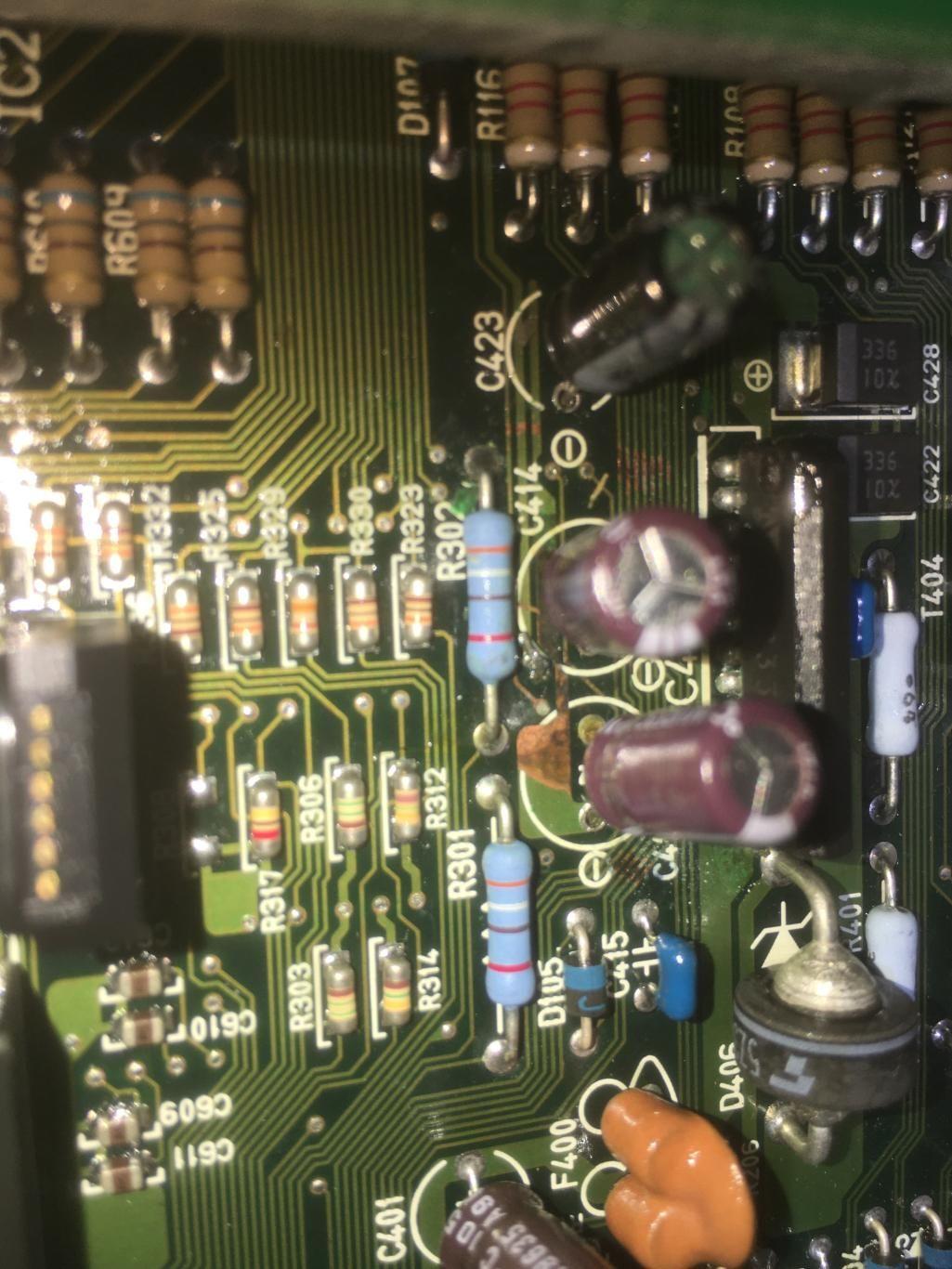

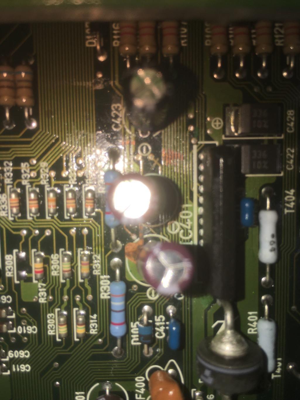

I pulled apart the ECM and took another look. I found a few traces around some capacitors that seem to be exposed completely.
Anyone think that this ECM is likely caput?

It is probably OK.
Someone has been in there previously (C423 has been replaced), and the exposed tracks are likely the result of a previous clean up of leaked electrolyte.
Since you already have it apart, I'd recommend changing all seven of the electrolytics. Even if they haven't leaked, they have deteriorated after 23 years. Give the affected areas on the PCB some TLC to remove any remaining crud and confirm all the tracks are intact.
I posted the Nichicon part #s and sources here:
https://www.jaguarforums.com/forum/x...6/#post1806456
May not help with the P1637, but it's worth doing and the parts are only around $5-6
