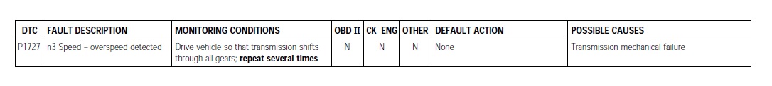

The Jaguar transmission control system fault code lookup only gives the following explanation for P1727:
All that shows is the n3 speed sensor has detected an overspeed situation and gives the possible cause as mechanical failure. I hope other members can tell you more about this.
