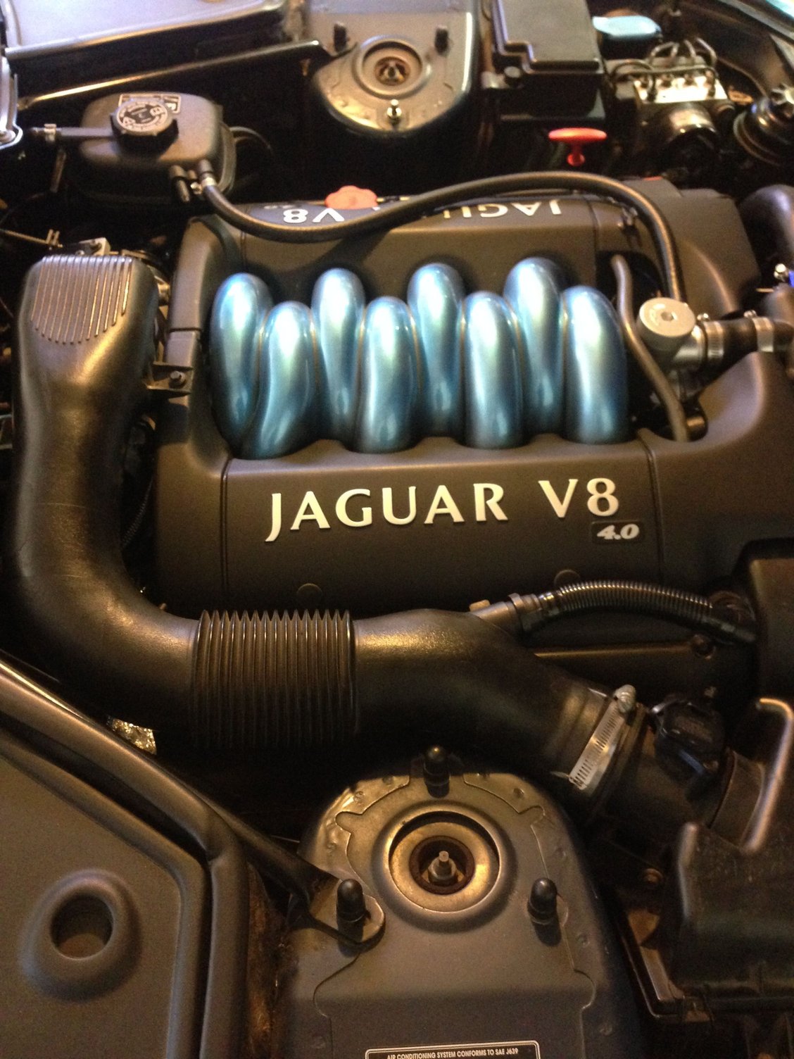

I had really good experience painting the intake manifold.
The real work was sanding down the plastic to make it appear smooth. I was going for the colored chrome look.
The real clincher I found was a clear coat at the auto paint supply store that they call it 2K. It is a two part paint available in a spay can. You just turn a valve in the bottom to allow the two parts to mix.
Long story short, it is heat and automotive chemical resistant.
So far all I do is dust mine off

From: The Wild Wild West
Yup. And where there's a will, there's a way.
Nice looker Flyboygus.
