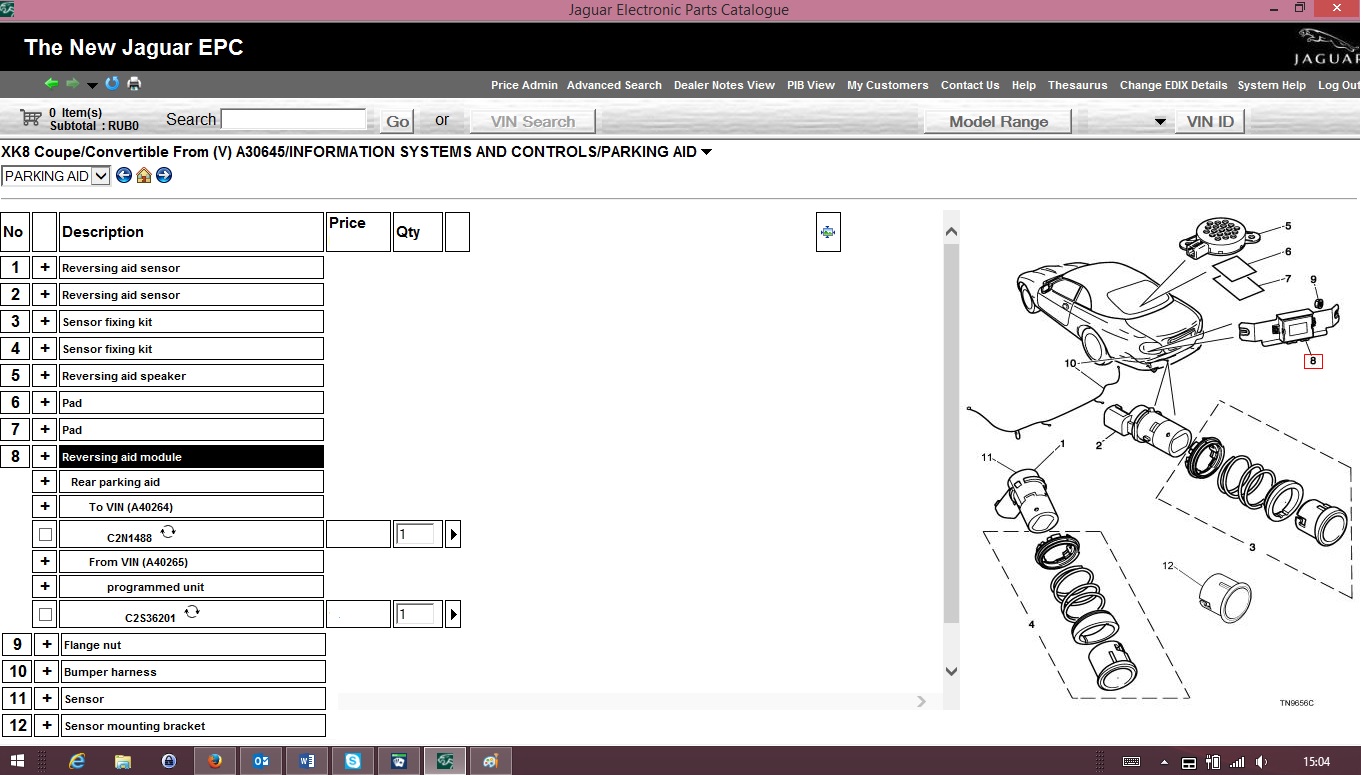

My immediate thought was 'NO' because I've retrofitted Parking Aid to a 2001 XK8.
However, checking the Parts Catalogue shows the Reverse Aid Module became programmed from VIN A40265:
If your vehicle is VIN A40264 or below and the donor module comes from a similar VIN range, it should be compatible.

Mine VIN is A36190 (a 2003 XK8) I've been doing the web search via part #, should I be able to find one referencing VIN #'s?
Old Oct 19, 2014 | 04:04 AM
Likes: 17,016
Your VIN is prior to the introduction of the programmed module so you need to source a similar replacement and it should just be a direct plug in.
The programmed modules started with MY 2004.5. You can either search by Part Number or Model Year.
