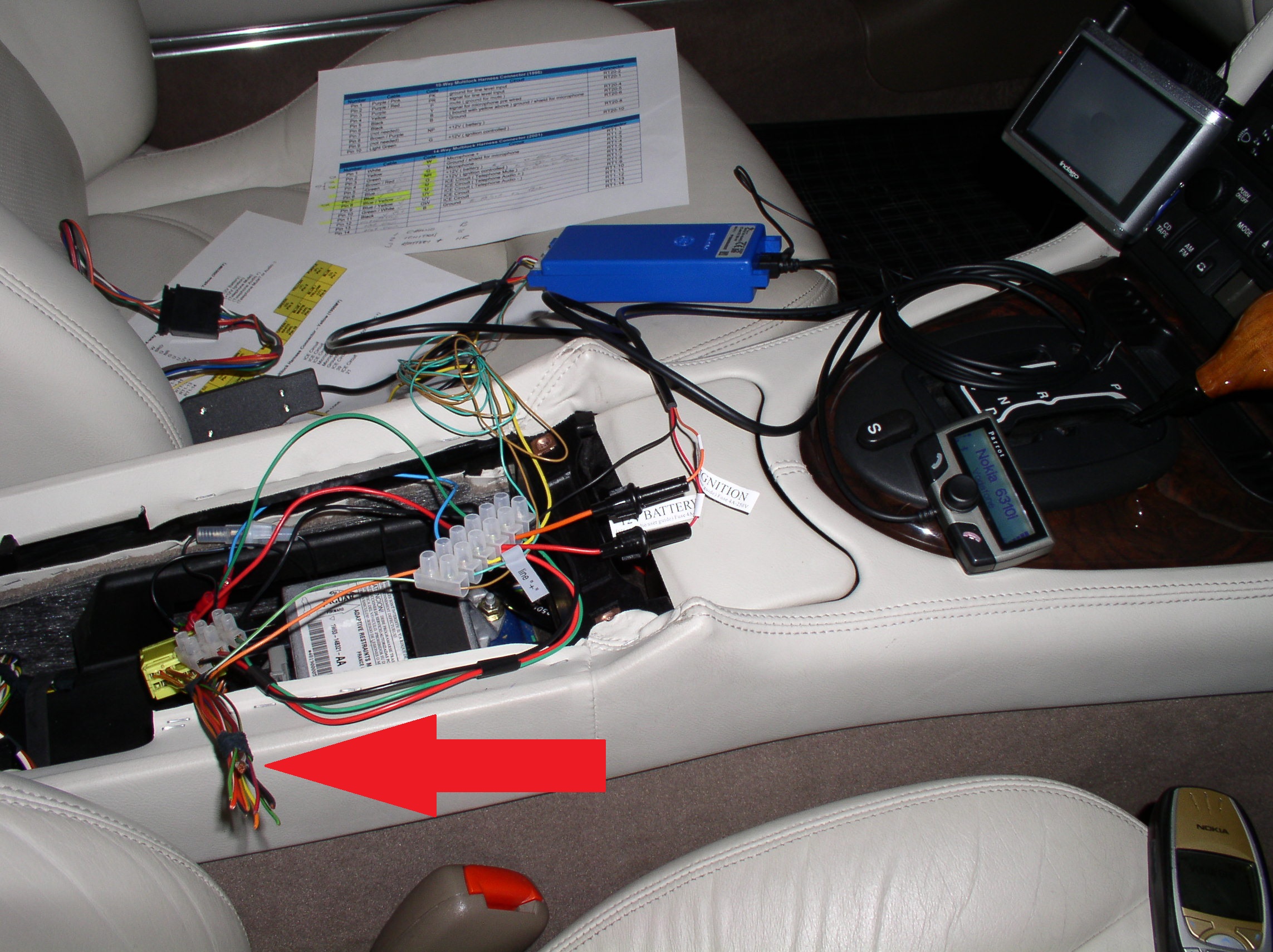

When fitting a Parrot in my XK8, I didn't want to cut the 14-Way yellow harness connector so I obtained a wired plug from my local Jaguar breaker:
Several of these are used throughout the XK8 and XJ8 so we found a fully wired one and cut it off with about four inches of each wire left to make the required connections.
I hate cutting wiring harnesses (phone and audio 'specialists' in the UK seem to specialise in this kind of butchery) and this allowed me to connect the Parott without cutting the OE harness in my XK8.

Can anyone tell me where the phone mic would be in 99 XK8 convertible? I can find nothing that resembles it. Also, does anyone have pics of where and how they mounted parrot control box and mic? Would appreciate any info or pics you have
Old 07-30-2016, 09:50 AM
WhiteXKR's Avatar
Join Date: Apr 2010
Location: Arlington VA USA
Posts: 7,652
Received 2,981 Likes on 2,123 Posts
On a convertible, use the twin noise cancelling mike that comes with the Parrot kit, it will work much better than the factory mike.
The Parrot control module should fit under the armrest cubby.
Some other hints are in the write up I did a few years ago, attached. The information on streaming audio connections is obsolete though since the equipment used is no longer available.

I have no problem putting control module in armrest. Just wondering how and where people mounted mic and display module
Old 07-30-2016, 09:55 AM
WhiteXKR's Avatar
Join Date: Apr 2010
Posts: 7,652
See the picture in the document I just added to my response above. The 9100 can be done in a similar fashion.
