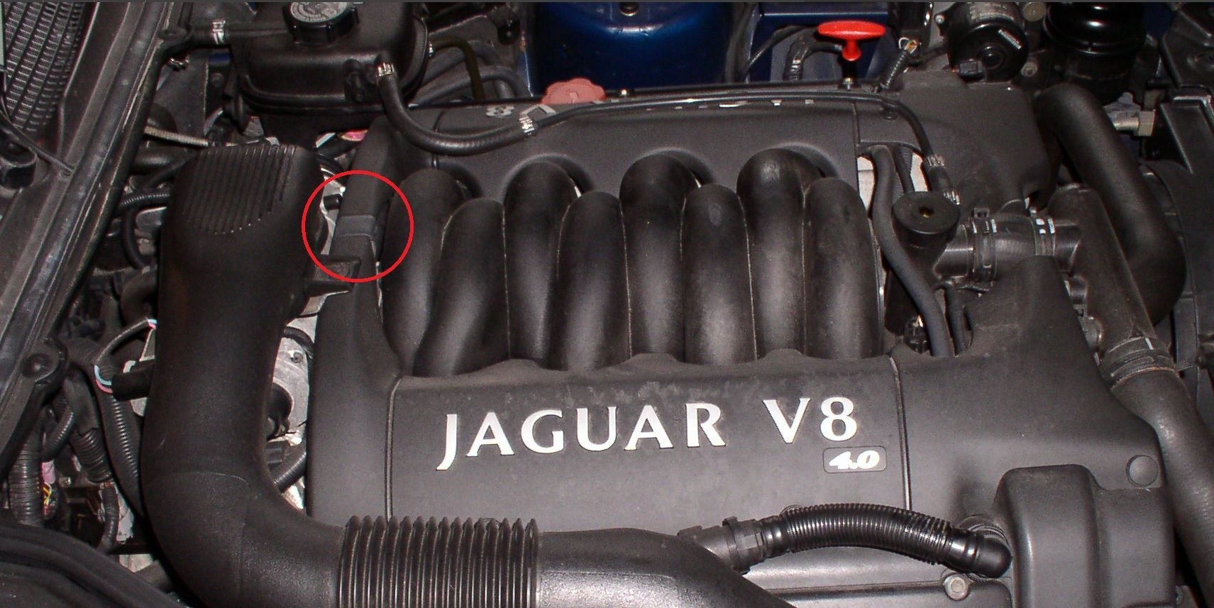

Old Jun 29, 2020 | 03:29 AM
Originally Posted by michaelh
Most of us, I suspect. I've only ever seen one picture of a motor with that in place. ......
If the pictures are that rare, here's another example on my 2001 XK8:
I suspect that, because they are awkward to refit, many don't bother.
