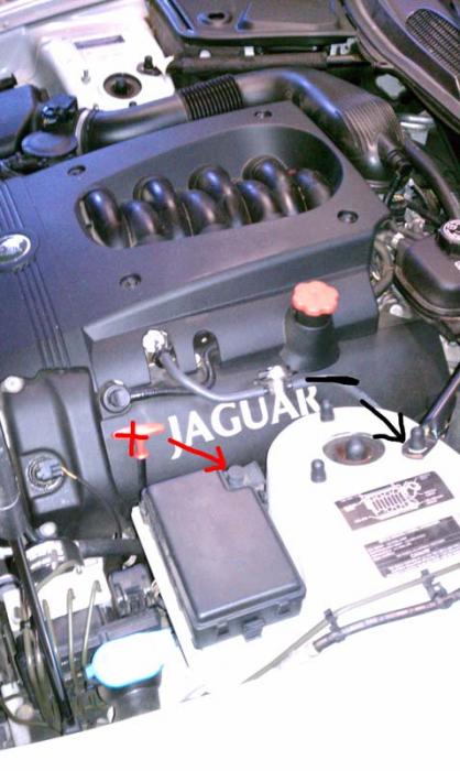

Rev Sam I think I really made a boo-boo. Since all my interior lights were staying on (because the car thinks the passenger door is open) I disconnected the battery in the trunk. Problem is, I closed the trunk. The key does not open the trunk (both black ones). So it must be electronic. My question is Were can I put jumpercables on my XK8 so that I can get
12V into the system so the trunk will open. I can't find anywhere to connect jumper cables under the hood.

Your key should open the boot no matter what the condition of the battery. It is a mechanical link. Unless someone has tampered with that linkage. There is a "hot spot" under the bonnet on driver side. You can temp attach an external 12v to it and to ground and that should power it enough to open the boot.

Just kidding! There's a jumper point under the hood. On the left side near the fender there's a fuse box. On the newer ones there is a little rubber cap on one corner of the fuse box. That's the + terminal for the red wire. On older XK8s it might actually be under the plastic cover of the fuse box. Connect the negative wire (black) to any exposed bolt connected to the chassis.
