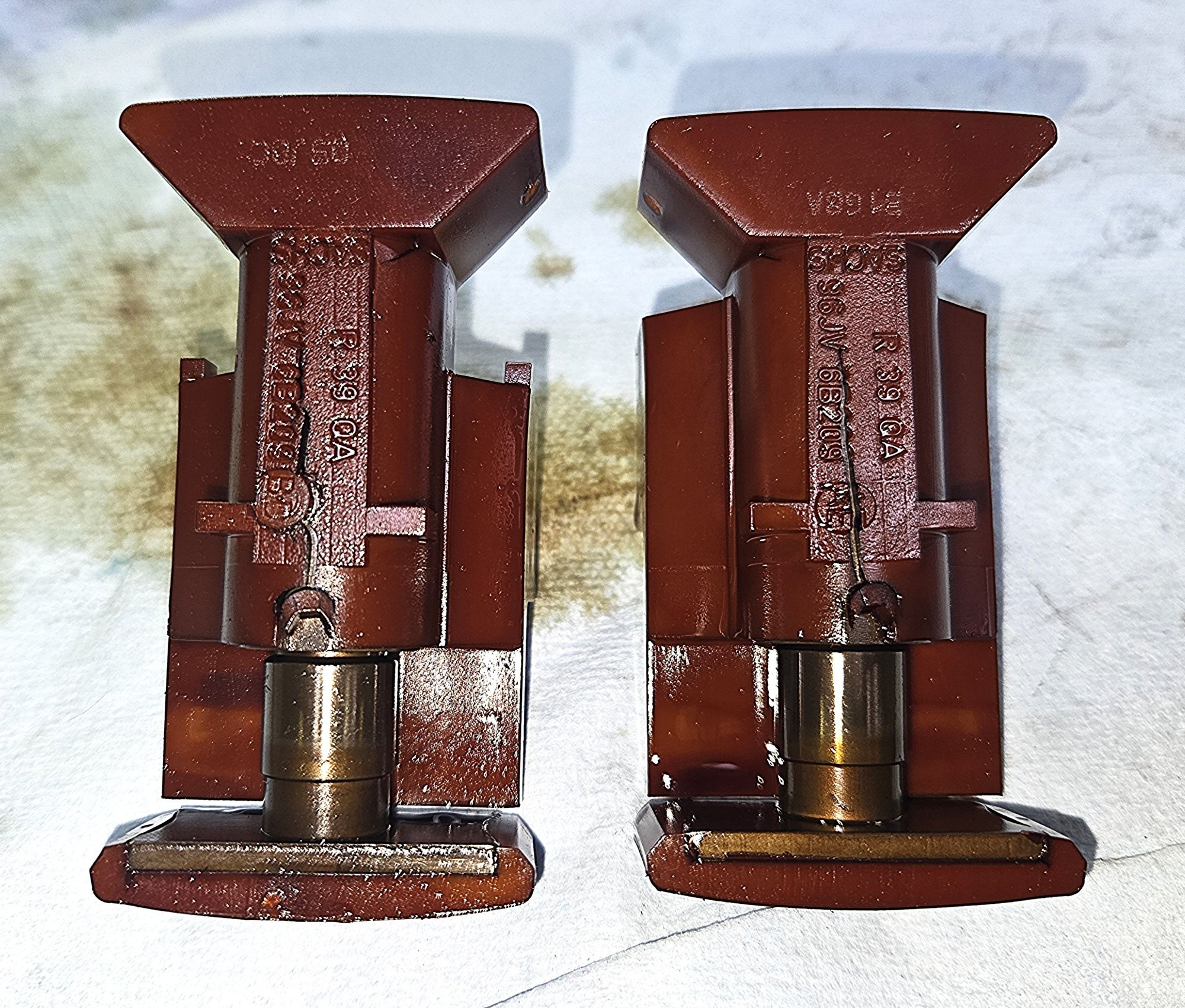

Sorry to join your thread late, but you've received a lot of great advice. I want to add that you cannot see the cracks in the plastic chain tensioners without removing them, so don't do what some of our members have done and view what little of the tensioner is visible in situ and decide "they're fine."
If the tensioners are plastic, they are not fine. Here's a pair I removed recently from a 1998 coupe. You can see why they are called "ticking time bombs." The cracks form on the side of the tensioner that is not visible when it is installed. This pair was ready to cause catastrophic engine damage at any moment:

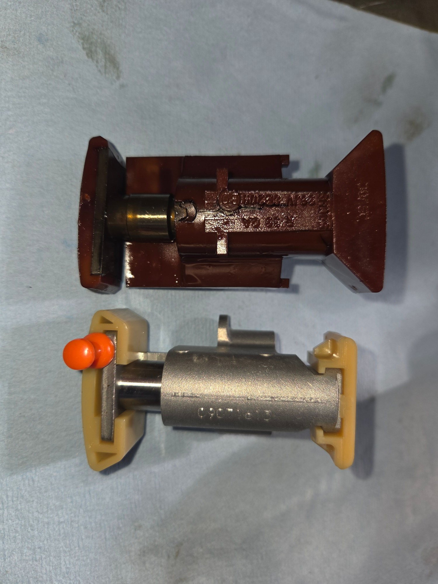

Here's a first-generation tensioner and a third-generation metal-bodied tensioner:
