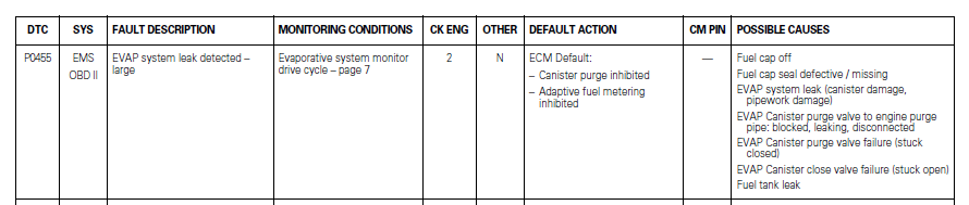

I'll be picking my new 2005 XK8 coupe tomorrow...the car currently only has 36K miles on it and has a check engine (P0455) which leads me to the canister purge valve? I read that it's a common issue for this car. Anyway, I wonder what kind of preventative maintenance that I should tackle right away? at 36 K would the plugs needs change? tranny fluids? differential fluids? I came from Saab World (well still do) so I usually do my maintenance myself. This would be my first V8 ...yeees..
2. Where would majority of you find get your parts from? As soon as I drive it home from San Jose to Oregon (with the P0455 code on) I will replace the canister right away.

Hi.
Two valuable tools are JTIS (Jaguar Technical Information Service) and JEPC (Jaguar Electronic Parts Catalogue). Both available in "sticky" section.
Attached P0455.

No harm driving with the P0455 unless you have an overwhelming fuel odor. Before replacing the purge valve, inspect the plastic and rubber pipework under the car connected to the two rectangular black plastic boxes (the charcoal canisters) between the rear wheels. A detached, or broken plastic vapor pipe, or a deteriorated rubber hose could cause this also.

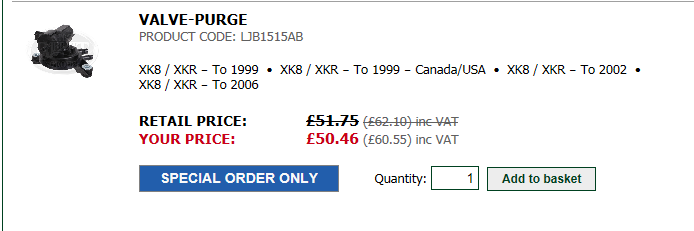

Do you guys know if the part no LJB1515AB applies to 2005 as well?

[QUOTE=zidjan;1167860]Do you guys know if the part no LJB1515AB applies to 2005 as well?
I think it does.
