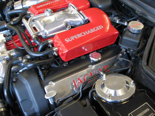

I am not one for badges, I prefer the "decluttered look"...
When I paint the charge coolers I then go over the lettering with some 180 grit wet and dry, once the paint is off go over with 1000 grit, you can then get a good polish on the aluminum just using paint rubbing compound so it does not upset your paint work..... This looks way better than trying to paint the letters
Take a look at this pic and you will see what I mean

And THAT, gentlemen, is how it's done.

Yes XKRACER,
Now that is BEAUTIFUL!
Without question as good as it gets!
Where did you get the metal caps oil,brake,dipstick and Jaguar cover?
XKRACER you do this professionally don't you? If you don't you should...
I was pretty much planning on the sanding of the letters, like you have done.
The 180 grit wet was tough enough to get thru the epoxy paint huh?
Did you use it wet or dry?
All by hand or did you use a machine or a sanding block?
Did you use a clear coat after all done or leave the letters.
The V8 area did you sand that to shine or is that painted?
What about colored hoses, anything I should consider with those?
I really like the metal accessories please let me know where to get them. Are they pre painted?
Are they chrome or aluminum?
Thanks for your post.

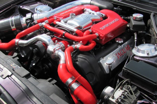

Yes I must admit I do this for a living....
You should click on my web address below my signature (thanks Norri ), then look on the lefthand side and click on Engine Upgrades and Detailing (I made that a link for those that dont want to go through the whole site!)
Here's one I finished the other day
I do not use epoxy paint but 2K, stands up to the heat no probs and easy to look after, but doing the lettering the way I said will still work but like you say a little more elbow grease is involved.... All the bling you see is made by me and as far as I know I am the only supplier of purpose made silicone hoses for the XK range (X100)
The V8 top plate is polished as well is the main water pipe/thermostat set up. The coil pack covers are billet aluminium engraved, polished and then the lettring painted red to match the hoses.... The polished aluminium induction pipes are also made by me, basically I can do anything you want even change the engraving, I have done the coil packs with R logos before, I would even put something on there of your own liking if you wished........ All in the aid of good fun tinkering with your favorite toy!

Thanks XKRACER, your "Stuff" is really cool.
Wish you here in Arizona. I could clean your floors for trade.
The unfortunate thing is I'm retired and would have to go get a job to do the things I would like and as we all know the job market is not so good here in the good 'ol USofA.
So I guess I will need to stick to what I can do myself. Not so perfect as you, but not so bad for me.
Thanks very much for taking the time to post pictures and all, they are works of ART.
