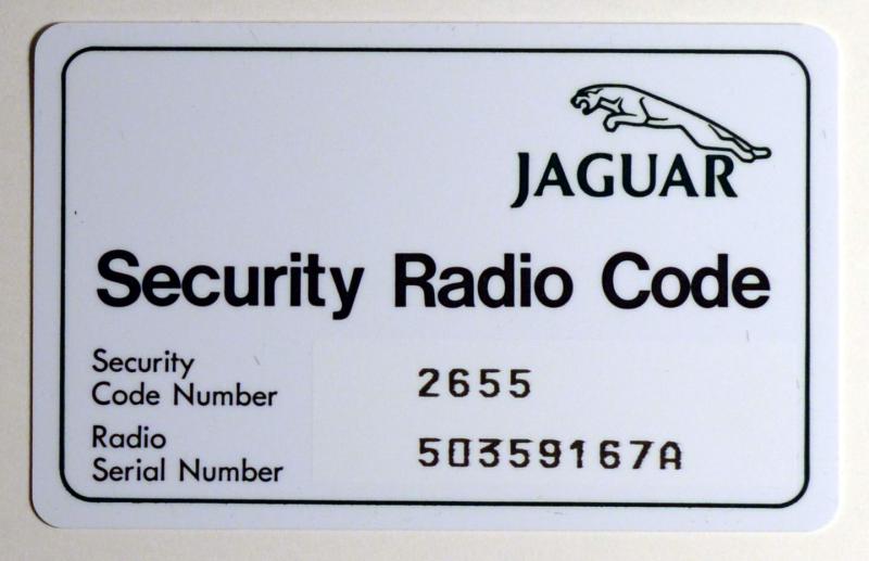

All UK radios are coded. Elsewhere it's unusual, but not unknown to have a coded radio fitted.
Some US members have Radio Code Cards in their Vehicle Literature Packs but still don't need to enter a code after a battery disconnect.
If you do have a coded radio, there should be a Security Radio Code card like this in the Vehicle Literature:
The code is always a four numeric sequence.

I did a hard reset this evening to no avail. Now asking for radio code that I do not have.

4. Radio - powered (after fuse replaced) but code locked
Although you'll see ads on the likes of eBay for radio decodes from the VIN, there have been a few reports of this not working.
The easiest and quickest solution is to ask your Jaguar Dealer for the code. They will require proof of ownership and may charge but many members have reported getting the code at zero cost.

2. if the radio code is not properly entered on three successive attempts the radio will display "please wait" and will not accept any entry until the radio has been left "on" for one hour. After one hour in the "on" position, the radio will accept three further attempts to enter the correct code.
